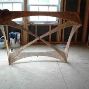

Hey, while we had a few minutes of free time on the job last week, I cut some scrap OSB into 4 arches and 2 ellipses and nailed them together to make a groin vault. I'm thinking I'll get to do one this winter.
