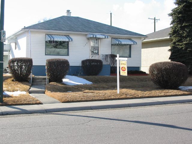

I just bought a new house in Calgary, AB (Canada) this week (take posession on may 7), and I’m starting to plan rennovations for the summer months.
The house itself is a 900 sqft. bungalow in an upscale neighbourhood on a 50′ x 105′ lot. The exterior features unmemorable siding, small concrete porch, poured concrete walkway and some large bushes in the front yard. I want to start fresh with the exterior, my primary concern being a low material cost, and high return value upon resale. I will be doing most if not all work myself with respect to the exterior work.
I want to incorporate decorative lighting into the design (i’m a sparky), and a more modern look to hide the house’s boxy 1950s exterior. If I can figure it out, I’ll attach a picture with this post.
What I’d most like advice on is:
What does it take to remove a poured concrete walk? How thick are they usually poured? -Ditto with the few concrete steps to the front door.
What kind of materials are cheap, but are associated with a large cost for being labour-intensive? If i’m doing the work, I don’t mind labour intensive projects if they will yield a high return. I have a limited rennovation budget for the whole house and need to make the most of it.
How would I go about removing the bushes? I expect to be trenching in the front yard to do the lighting. Can I trench strategically to make bush removal easier?
I’m interested to hear any input. I’ve never had to take on a project of this scale, but I want to hit the ground running on posession day.

Second, to add curb appeal, that house needs a nice porch, or at least something over the entrace. Do no remove the siding...it looks fine. New siding is extremely expensive when all is said and done.

OK, so start with a bobcat (skid-steer loader) to rip out the walkway and the steps (if that's what you want), and to did your trenches. Ditto the bushes.
Build a nice porch with steps to a wide entry deck with planters on each side. Remember how lumber reacts to your weather, tho'. Put some kind of entry porch over it all - perhaps like a portico, or maybe bump out a bay window so that the roof of that continues over to form a verandah. Very wlcoming those are, you can sit on it in the summer and chat to the passers-by. But looks like you're right on the setback/building line.
Bring the pathway more in line with the front door, if that's the way you want visitors to enter. not dead straight, tho', slightly meandering.
Looks like vinyl siding -only hope it's not covering up nasties. Pry off a little in an unseen area, and make sure. Sorry, shouoldn't be worrying you. It's more likely stucco under, and that someone has decided to make it up-scale. Don't touch it nor replace it, it'll do you a few years.

Everyone loves a porch and they are very popular. However, they are not cheap, but more importantly you have to think about the roof lines. I think a porch across the front would look funny. The problem is the hip roof and teh fact that the roof is a pretty low pitch.
I think the portical idea is better. I have seen some beautiful ones with brick stoop or decking. Maybe something in the area of an 8 by 8.
JMHO.
Oh, and if possible LOSE the ownings (spelling?).

You've got some good advice from piko already. Once that sidewalk and steps are out, some natural stone or a brick walkway would look nice. And a front porch/entryway would add a lot to the house. It's hard to snazz up this house much without adding on to it to make it less boxy.
A trellis off to the side might extend the lines of the house some without being a huge investment, there's a little article about that in the latest FHB, too.
zak
Concrete walkways are usually formed with 2x4's, so they are 3-1/2" thick (most people say 4" thick) (guy I work with actually digs 1/2" below the form to make them the full 4" (required by code?). If you don't have a lot of concrete to remove, a sledge hammer works. Works better if you can use a pick axe or wrecking bar to pry up one square and rest it on something, then the sledge will crack it into pieces better.
For removing shrubs and such, if you don't have access to a trencher or tractor, be sure to dig around the roots (trim the brances out of your way first), cut as many as you can with an axe or mattock and rock it back and forth to expose more roots and chop those, then pull it out--either by hand or some people hook up a chain and pull it out with a truck, cutting any stubborn roots as you go. A neighbor tried to just hook up his truck to a yew in his front yard and I laughed as he spun his tires. Went over with my loppers and an axe and used the technique described above. (I used to work for a landscape nursery.) Had the thing out in a few minutes. Same works with trees--there, as the tree falls to one side, it tends to rip out the roots on the other, or pull them up to where you can cut them. The advantage is there is no stump remaining when you are done.
For material for siding, maybe Hardi-board or similar. Looks nice, but is probably more labor intensive to install than vinyl, but also seems to say "quality" more than vinyl.

Your picture doesn't show the neighborhood but from what little I can see of the house next door it looks similar..
If that's the case the house you bought will only appreciate in relationship to the value of the neighborhood. Other than maintaining the house there will be little if any return on improvements.

The foundation on the house is high, and the blue color emphasizes it, kind of like a stripe. The right hand side seems to display that a little less. I would lose that dark stripe, try to go a little darker than the body paint for the house, to differentiate it, but not really dark.
The advantage of the sideways steps is that they take up some space on the front and they divert some of the attention from the foundation. I wouldn't turn them back to the front, and would leave them in that direction for that reason. Putting a deck on the front might or might not work legally with codes setbacks etc. If you get involved with a deck in the front, it's going to change the style of the house. I think you would have to modernize the whole front. (BTW, how old is that roof? They haven't sold those shingles around here in 30 years.) My solution would be to get some tall plants in front of the base of the steps too, or maybe some kind of a built up planter box. You might be able to add some brick or stone edges to the walkways and cap them with a stained or tinted concrete. You need to look at the numbers for this. If you have a source for used brick, you can do a brick and sand or brick and cement walk. Labor intensive but nicer to look at than concrete.
Spending some money on landscaping could make all the difference in the world.
Looking at the awnings, I think they look dated too. But there may be a sun problem and those windows are BIG expanses of plain glass, almost too big for the front. the awnings minimize the size a bit, so I wouldn't be too quick to tear them out. Again, maybe a repaint? For the windows, if possible, I would try to get false grills inside that could break the visual expanse of the glass up. At least 6, up to maybe 9 panels per in each window.
If you have any money left after the kitchen bathroom and studio, maybe reside the front of the house, even if you can't get the sides and back done. That could help too. As much as I respect the opinions you get here, your best investment now might be a few bucks paid to an architect, designer and/or landscape designer to get you a plan (with a drawing or rendering so you can see it before you do it.) I know I've lost money befoe by doing my own design.
By the way, since you are an electrician, you can probably do some nice updates on the lighting too. I don't know how well you get along with some of the quality local builders, but maybe you can trade a few days work back and forth?

"... low material cost, and high return ..."
Sign me up brother. LOL!
Congratulations. Unlike me, you bought house with a fully functional roof, LOL. You get to do fun things!
Since i don't know what you paid, how expensive the area can get, or how long you plan to stay, I'll just list some ideas...you can make financial sense out of them if you want.
I should start by saying I hate vynl...can't even spell it, LOL.
So if it were me, I'd look for an alternative, and do a remake of the house, perhaps a little at a time. front first of course. I like the idea of an entrance, so i would deep six all the concrete, create a portico, and make the steps lead out rather than at a 90 degree angle as they are now.
I'd toss the awning things the day I moved in...might even make that part of the buying agreement, LOL
I'd also retrim the windows, doors and perhaps the corners too with a wider more substantial board. I think wide claps, painted a putty color, decent trim painted a warm buttery color, and a good entryportico with an eye to "craftsman style" beams and posts would transform this house. A simple front door, maybe a two panel with two upper lights, either cherry toned or painted (dark bottle green?) is a must.
A meandering walk to the drive and the street, and a picket fence painted to match the trim will work wonders. Don't make the pickets even along the top. Drop them in a gentle curve between the posts...the house needs variation.
Top it off with some cool crafstmen light fixtures (sconces), outside accent lights for the fence, walk and plantings, and you'll have a house that should be on that TV show "Curb appeal"

1" x 8" x 12 ft long pre primed cypress imprint Hardie Baord is like $5.50 a piece at Lowes.
Looks great and no wood pops, sap leaks, twists, cracks, rot , water wicking, bug eating etc etc
Get rid of the goose on the screen door.
Alright I'll bite - what in the owrld is a 'bungalow' if this is not one. Is there a standard deff??FHB often includes a remodel job on what they call small spaces. Its amazing what vision some folks have when it comes to wood/concrete. Wish I had it - but NO talent whatsoever. I removed steps like yours once with the bobcat idea - it was so much fun I took out all the cememnt anywhere near my house. Cost a fortune to replace but I sure did like that little machine.Mike C
Apparently the word means different things to different people, but this is what we'd call a bungalow here in Minneapolis:
Well now that we know what a damned bungalow is lets get back to the question!

Greetings and Welcome to BT, first off.
Sweat and planning. The walk can be "busted" into manageable pieces, and dug out with simple tools like a stout sledge, a breaker bar or two, and a pickaxe & the like. Pacing is pretty important in that sort of work.
The steps will be much more work. Often (if they are not attached to the foundation), it can be easier to bolt in a bracket or some eyes, and just tug them out, away from the house. Now, we run into what may be your bigger hurdle--where to put very heavy debris (as you likely do not want to leave a dumpster/skip on site until you get finished).
What kind of materials are cheap, but are associated with a large cost for being labour-intensive? If i'm doing the work, I don't mind labour intensive projects if they will yield a high return. I have a limited rennovation budget for the whole house and need to make the most of it.
Which can be true of so many of "our" houses. First on my list that you should do is to get ahold of all the restrictions your lot has (or may have). You don't appear to have a lot of depth in the front yard--you might not be able to put a decent porch in, in that depth (only your AHJ can tell you). This does not mean you could not have some stepped terraces, decks, or the like, with pergoloas or similar for seasonal shade.
Now, what finish is going to be best for your house is going to depend on the neighborhood a bit. Sure, you could strip down all the existing siding (or in some proportions of one or more "sides"). You could then apply cultured stone to create a "base" and then run stucco above that to create a Prarie-style or Foursquare-style sort of house. But, that might make your house the only one like that for miles and miles. It's your house, so you do have some lattitude in making it look the way you want it too.
If they are worth saving, and your future plans allow, sometimes transplanting is better for "mature" growth like that. Otherwise, using the trencher can help you no small end. Hack out the bottom couple of feet of the branches, and run the trencher around as many sides as you can, a couple of feet deep. This makes a "dado" of sorts, rather like when using a circular saw to make a half-lap joint. With the trench cut in, you can generally "tip" the bushes out of place. Trickier part can be deciding what "fill" to put back.

From here it's not a "bungalowe" but rather post WW2 subdivision housing, simple yet functional, usually well made. A porch infront of a hip roof can be difficult without changing the whole front into a gable, which could add some upstairs living space. If not a flat roofed porch with a simple widowswalk railing? Or a small gabled portico with tapered wood columns (with masonry bases) flanked by trellised arbors over the windows? Include some morning glory plantings? What about dropping the porch to a patio with curved front stairs to the entry like a dias, add a pergola or two for shade? That would bring loungers to sidewalk level, a little more inviting. Research and look around, trying to transform a house into a complete style can be daunting and expensive. In England they call apartments "flats". A bungalowe is a modified cape cod, the front being gabled rather than the sides, or the front slope of the roof broken up by a large dormer, often with a porch consisting of massive columns that were rectilinear as opposed to the neo-classical and colonial cylindical columns or Greek and Roman origin.
A reversed gabel would do that house wonders. It would be a very cheap addon because the foundation is already there for the porch.
blue
blue,
how much would a reversed gabel set me back? - i am reluctant to look at changes that would remove anything that's already of reasonably good quality on this house - ie the roof, but I also have no frame of reference for what that kind of project would cost. - i typically work on new construction in commercial/light industrial.

The foundation is there? perhaps I'm not understnading, (my fault of couse, whats a "reversed gable"??)
If you mean a little gable thats 90 to the ridge, and a entry room on the cement stairs, will teh stairs pass code as a foundation?
