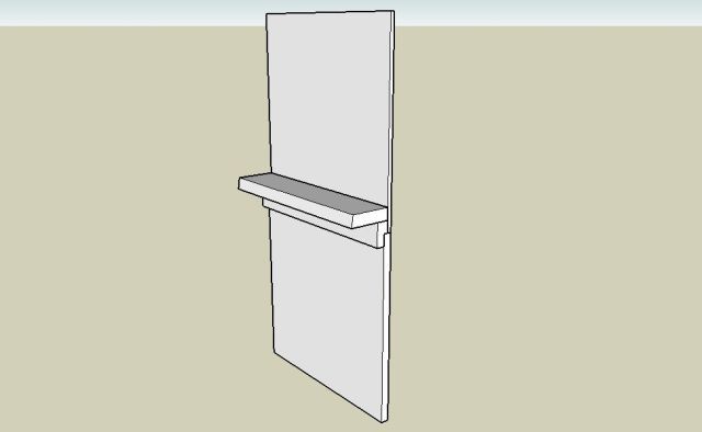

    OSB up to 4 feet high, poly over the upper half, then 1/4" tempered pegboard over the poly.  Screw on a horizontal rabbeted 1x2 as a cap over the joint, and screw a 1x3 continuous stool to that.  You can set and hang all kinds of stuff to that stool.
    Get the heavy duty pegboard hooks in all shapes and sizes and you can hang up all your plastic-cased tools like screwguns, nailguns, etc., your huge clamp collection, all your power sanders, sawblades, chisel collections, planes, your world-class collection of router bits, yadda, yadda, yadda.

      Do you have a pic or a link or a drawing ? I really like the idea just having a little trouble envisioning the stool/ 1x2 detail... Thanx

        Gene_Davis | Jul 11, 2006 06:43am | #13
        It's a dust catcher, but handy.  Near a router table, it is drilled full of 5/16" and 9/16" holes, for bits.  There are many other uses.
