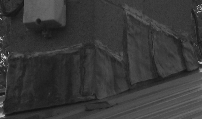

telephoto image of chimney
I got on site late today, and rain kept me off the roof. But I did get this much of a picture of the area that is leaking, using a telephoto lens and digital enlargement.
To my untutored eye, it looks like the counter flashing has some gaps, but I don't see any mating step flashing under it. Maybe it shouldn't normally be evident in this view?

I'm guessing that when the roof was replaced the installers didn't know how to work new flashing under the counter flashing properly.
Hard to make out the details -- what's that thick area right near the chimney -- is that sheet metal or something else? How is it connected to the roof?
Not exactly what I expected to see. All the components are there. The roof material appears to be "R" panel and the counter flashing is lead. Looks like the caulk monster has been up there as well. Get some pics of the top and back side of the chimney when you get up there.

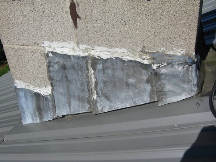

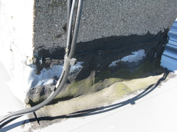

better pictures
Here are two shots. What my untrainted eye sees:
1. Lots of caulk between lead sheets of counter flashing.
2. Fabricated step on three sides, but no saddle flashing.
3. Depressions in tarred joint on "uphill" face of chimney, corresponding to the contour of the R-panel ridges, with at least one 1/2" pit that may penetrate as a hole.
The leakage damage is limited to below the "nearside-uphill" corner - which is where the tar depression is the deepest.(the dark linear shadow near the lower left corner of the second picture is just a shadow, not a crack in the tar)
Looks like the back pan (where the tar is smeared) is lapped under the base flashing on the sides when it should have been lapped over. See if you can lift the lead flashing on the back and loosen up the ridge piece. Bend a piece of metal (galvanized will work for this) slightly wider than the chimney up the back of the chimney and let it extend back up to the ridge.
Cut the excess length at the sides so the verticle part can be bent around the sides of the chimney. You may need to caulk the corners and bend the counter flashing back into place and screww the ridge back down.

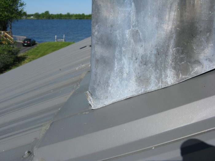

found it.
On closer inspection, the pan is, as you guessed, not overlapping the sides of the base flashing. In fact, it is so dished downwards, I suppose from winter ice and snow loads, that it forms a very nice holding basin for water. Not only that, but the junction between the pan and the ridge extrusion had opened about 80% of the way across. As the water level rose in the "basin", it would eventually overflow at the back (i.e. ridge side) of the pan into this large gap where the tar had split, since there was little pitch at this point.
It is not visible in the pictures, and I didn't see it before. In the second photo, it is under the shadow from the dish cables, and not really very visible at all when you're looking from that direction. The gap is up to 1/4" wide and runs nearly the full width of the pan. It would certainly account for the leakage, I think.
So I've temporarily resealed it with cement, and on my next trip up here I'll have some sheet metal tools with me, and something suitable to install as you described.
