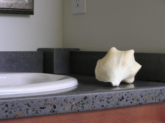

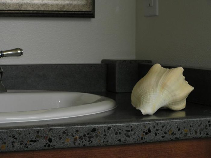

less water more strong..
to less water to many pocks
much more backfill..rebar is a for sure to avoid cracks in thin crete..
a polisher is a good investment..
exposed aggrate is nice on a front beveled edge..if you can bake a cake
your concrete shall be real nice..
if not, you can have cool yard ornimentspoor on glass and its like steel
add metakaolin for mega strong crete..thanks again
I like that front edge a lot.Did you cut it, then polish, or did you just just grind away.
I have always wanted to try a concrete counter, but really hate the cost of tooling up for a one or two time thing. The polisher isn't the problem but the diamond pads are way expensive! Is there any way around this problem? Any other type of abrasive that might work? I really like the look of exposed aggraeat.
By the way; very nice work!!
its polished from 50 to 1500 grit
yea the pads are spendy and
they dont last that long...bummeri guess you can cut it with a dimond blade
on a skill saw..hard to get strait i wood bet..crete has such a good real feel
is contains the life you put into the process
its cool and can be made warmthings i suggest
pay to have it done
or get lucky on your first try
or end up with lots of yard decorthanks as always
