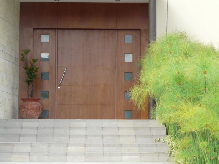

We are looking for interior and exterior/entry doors on a contemporary style.
We would love to make the door below be our entrance door but we keep getting insane quotes. View Image
We are currently looking at using regular hollow slab doors inside and routing lines on them without compromising the integrity of the door. But for the entrance door we still don’t have a solution.

Just what is an "insane quote", please?
Kowboy
Kowboy's got a good question.
Around here $10,000 - $15,000 for a custom door like that wouldn't even cause someone to blink their eyes. Is that the kind of insane quote you're getting? Or $25,000? Maybe that would be kind of insane, but then again it also depends on what all you're getting with the quote...frame? sidelights? casing? hung? , etc....That looks to be about a 4' wide door, and probably heavy as sin. And if you're going modern style like that it should have a nice, small, even reveal...it's gonna take a little fitting to make that sucker hang just perfect and the right kind of hardware as well.Paul
http://www.pauljohnsoncarpentry.com
Well we've gotten anywhere between 5K and 22K. Insane on our eyes I guess, considering how simple the door looks compared to other doors we see that are much more complex and sometimes cheaper.Our cheapest quote by far has been having the door made in South America and spending 2K to bring it to the US. The problem has been communicating with the company in South America and their timeline.
If you want to do a bit of research to understand what it takes to build a door such as that, please take a look on the woodweb (pay close attention to discussions by Dave from Acorn Woodworks). It is a ton of work to build that properly so it will last. Trust me, its not just a simple slab of wood with a couple of grooves and hinges from the borg. There is most likely a ladder frame in the middle, special hardware to hang it (probably 2.25"+ thick), and some huge $$ in machines to build it. $15k is reasonable for a custom such as that.
Unless you understand how to build that door assembly properly I would stay far far away from the South American route, well, that is unless you want to replace the door in a few years. Dont expect them to show up to complete any repairs.

Buying the door from anywhere but local is a mistake in my opinion.
Whoever builds it should instal it as well.
You don't want to mess around with something like this.
Get someone who will do it right from design to instal.
In the end you won't regret it. "There are three kinds of men: The one that learns by reading, the few who learn by observation and the rest of them have to pee on the electric fence for themselves."Will Rogers

For the exterior door, what if you use a slab metal or fiberglass exterior door and mount wood panels on it. With the right finish color, you may have a fairly close replica of the picture you posted.
Thanks for idea, I'll discuss it with my builder. The door doesn't have to look exactly like the one on the picture, we are just hoping to get something on a similar style.
I can see how the door, sidelights, and transom could surpass $15,000 and possibly approach $20,000 or more, but then maybe someone will apply a recessionary discount.....

I snooped around your website. I hope you dont mind :) Its a great site full of wonderful woodwork projects. Even a door in production. Its interesting that the focus here is primarily on cost. That is one huge door assembly the OP is looking for and the fabrication options are vast.
Thanks, I've been at it a while. I'd say to your comment that, "That is one huge door assembly the OP is looking for and the fabrication options are vast." Well, I'd say there are only a few methods to produce an exterior door like that one, which will stand up to sun, rain and snow, and an occasional slamming by the kids, all the while remaining sound and good looking.Gary W
