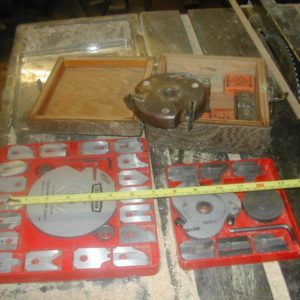

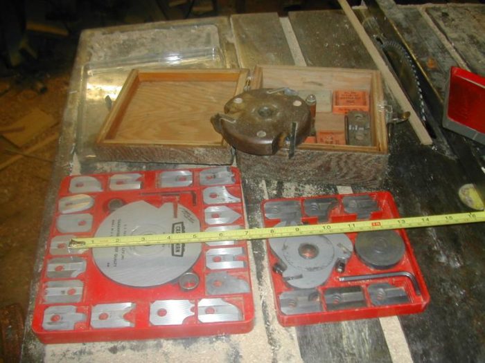

    I used my RAS with the router attachment to make most the moulding from my house 40 years ago (when poor, young and dumb). I'd usually make an outboard fence with a 2x4 with the cutter as far back as possible.
    I CANNOT conceive of even trying to use that 4" single blade finger butcher ever again on the RAS, even more of a fear factor than ripping on RAS.  (have not ripped anything on a RAS for about 35 years either!)
    the 3 blade guy could make lots of different cuts with different blades in each slot, but sure could vibrate then too!
    The larger diameter worked better on RAS.

      I also have made many feet of trim with the kits you show.
      Single blade unit is great for custom cuts as you only need to make one blade. Trick is to make sure you cover as much of the blade as you can!

    The outboard end is too slow, you need either the 3 knife molding head ( like Art showed) OR actually mount a router on the yoke somehow.
    Ryobi had a small 8.5" RAS that DID have the RPM on the out board shaft..I made 100's of feet of custom molding with one. That motor spun up way faster than the 3450 of a reg. RAS. 5K on the blade IIRC, and 22K on the shaft.
    I agree that the single knife molding heads are insane. Even in a table saw they are just too prone to taking too much of a bite.
