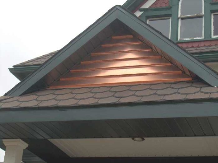

I had a lot of copper flashing material left on the remodel I’m doing. (HO ordered way to much) So, to use some of it up, I bent the 6″ strips on a brake into ‘lap siding’ to side a couple little gables with. Turned out kinda neat.

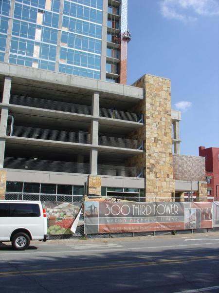

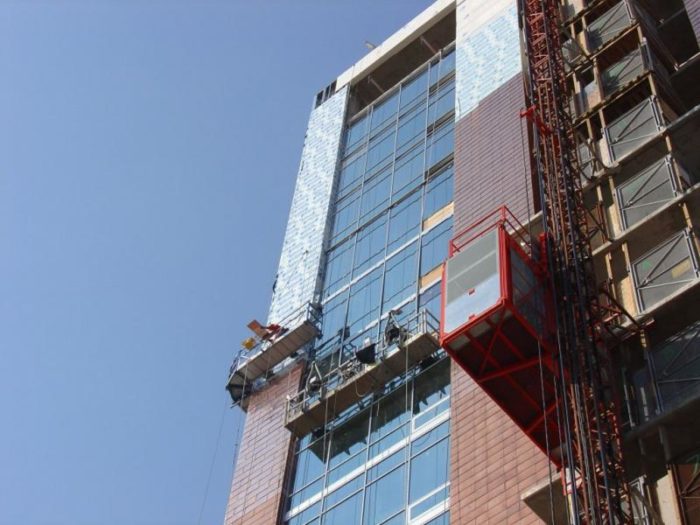

This building is under construction in down town Little Rock. Can't help but take a few pics (when have camera at the ready) everytime I walk by there...

must be an insuranse bldg or banking..
Oil company?
could be that too..
I'll try and walk by the side of the project that has the sign board...next time I'm up thtat way.
There's pretty chintzy chain link security fencing round the bldg site. I'm guessing they have more security on wherever onsite they're storing their CU supply.DUM SPIRO SPERO: "While I breathe I hope"

When I went by that bldg in Little Rock and stopped to take pictures...some ladies on sidewalk beside me, when noticing that vertical sections of the copper sheathing "looked different" made comments about "oh I'm sure they'll clean it when they're done installing it" and I about snorted my coffee outta my nose (since they were noticing the oxidation of and on, the prior day's worth of CU sheathing!)
SO I don't ever assume too much...
BTW, that bldg I posted coupla pics from is a High rise - not bank, not oil bldg. And it's about 75% sold out! Found it's addy and website:
http://www.300thirdtower.com

Interesting -- how did you attach it? Are there hidden cleats, like a traditional copper roof?
-- J.S.
No, nothing that fancy. I bent it with a 1/2" vertical flange on the top and bottom of the piece. I held the piece in position then nailed through the top flange into the wall. The bottom flange of the next piece overlaps the top flange of the piece below it. I ran a small bead of silicone between the two, and also nailed it through both flanges with a few small copper nails. Harder to describe than to do; I could draw a sketch if you like.
I actually did the first gable about six weeks ago and the other just last week. Both have been through a 70 mph wind and held just fine.
