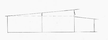

It is about 2.5 miles from the beach. The house will face west for ocean views and prevailing breezes. Huricane winds could become an issue as could huricane rain. It is about 300' elevation so "waves" will not be an issue. I intend to use huricane clips and see if Simpson really knows their stuff. I hope to frame/close in the rafters and allow ventilation through the screened clerestories and window/doors down below. While I am not phobic, their insects can be a bit more malevolent than those to which I am accustomed, The kind of window/doors I wish to use may be seen at http://www.nanawallsystems.com/index.htm My only connection to this company will be that of debtor. I will gain nothing from mentioning them. My floorplan and NW "elevation" are attached. I redid the windows in the laundry/sewing and need to update the elevations to reflect that change.

ken... last time we were in Coast Rica ('89) the vernacular architecture looked nothing like your design.. lots of open buildings.... exposed rafters.. no screens..
closest thing to my memory would be "american bungalow"
we went East Coast to WEst coast.. i don't remember bugs.. i remember lizards ( mebbe they got the bugs)..
lots of steel roofs.. light framing... large overhangs and pitched roofs.. my recollection would be 6/12 or greater..
me.. i would use local materials and local methods and local design..and probably local labor... great country.. great people

My standard answer to most rafter questions is 2X12's every 2'. The 5/8's plywood will only span 2', not sure what that is in metric. 2X12's should span 15' since you have no snow load. Or were you thinking of using some thing bigger in size like beams?
