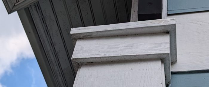

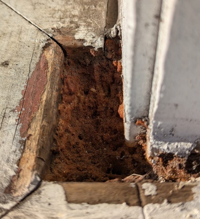

I’m in the Tampa Bay area of Florida. I have a reproduction of a craftman-style house that was built in 2006. The house has non-load bearing columns. The columns do not go to the top of the roof eaves; however, they are somewhat covered by the eaves. There’s approximately 30″ from the center of the column top to the eave. When in the process of replacing the caulk I was surprised to find that the top of the columns are not sealed. I think the columns are filled with a wood filler that has become a bit brittle over the years. Is this a valid construction technique? What should be done to maintain the column tops? I’m seeing what could be water damage at the column’s faux-brick base.  The photo on the left shows the column under the eave.  The one on the right is a bird’s eye view of the top of the column.
  1. calvin | Aug 19, 2024 04:11pm | #1
    Are you saying there’s no top cap on that faux column?
    1. dougw975 | Aug 19, 2024 06:00pm | #2
      That's correct. There's no top cap on the columns. The picture on the right shows the top of one of the columns.
      1. calvin | Aug 20, 2024 06:36am | #3
        Yikes.
        Hopefully they don’t build them like that anymore.
        I would take it apart and start over. There could (probably is) damage to the dwelling behind that thing. The wood “filler” I see looks like rotted framing material. This can’t be doing any good to what’s behind it.
