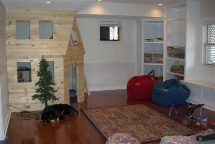

I live in Minnesota (Twin Cities area), have a problem with a cold basement. Unfortunately, the heating system wasn’t zoned when the house was built (1988) and everything is finished now (including walk out basement) so that isn’t possible anymore. At one end of the finished basement, there is an opening (size of a small window) going out to a crawl space under the mudroom/laundry room (the only area where there isn’t full basement). See pics below. Cold air comes tumbling out of that opening.
Question – will I freeze the pipes (plumbing to the wash machine & laundry sink above) running through the crawl space if I stuff the opening with some fiberglass? The foundation of the crawl space (and the rest of the basement) is concrete block, with 2″ foil faced foam insulation stuck to the face (on the inside). The floor above is insulated with unfaced R-19 fiberglass bats. 6 mil poly over the dirt floor, taped at the foundation.
Finishing up project turning this area into playroom for my boys. Tired of the cold basement – this opening seems to be a big contributing factor.
