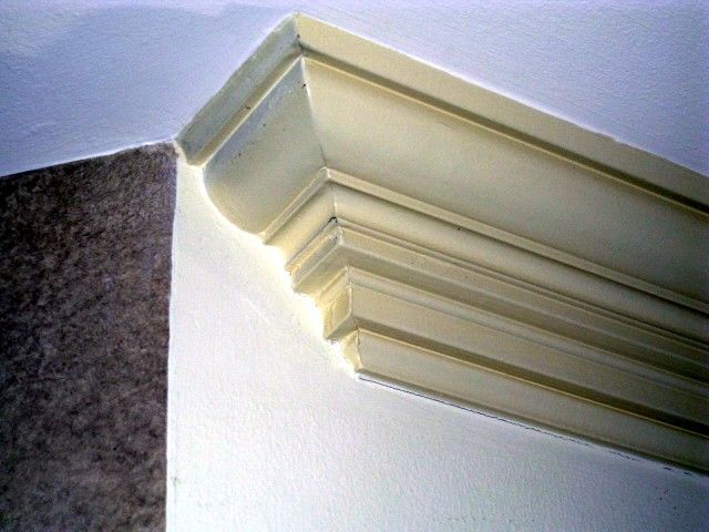

They are looking to match some crown molding and have hired two different people who both have told them that their molding is no longer available. Attached is a picture of the molding. It doesn’t seem to be anything special. Anyone have any thoughts about availability?<!—-> <!—->
I plan on heading over tomorrow to measure and use a profile gauge to get better information. I will also get better pictures. Is any other information needed?<!—-><!—->

It's probably a two piece crown. Fill in your location in your profile so we know where you are. There are shops everywhere that will run custom profiles but there is an upcharge for that. There is probably a local millwork supplier that may have that profile in their catalog. Some in my area have thousand of profiles in their catalogs with the knives but they don't stock it. Two weeks lead and you'll have it.
I think you're looking at something very special indeed. In fact, it's probably a built-up crown. That is, it's assembled from a variety of individual profiles, each of which, in its own right, may be difficult to find.
looking at the photo, it looks like upside down colonial baseboard with a standard crown applied over it.
It's not a standard molding. Crowns have an S shape, this one is an ovalo. The very top edge looks like it is beveled in where the ovalo starts. Not having an S curve is a big help in making a match. All the shapes are easily done on a router table and table saw. To have a specialist grind knives to match the molding would be very expensive. 100 lf. wouldn't be too difficult to make. As others have said, you build up individual shapes. I have a picture of some furniture molding I had to duplicate that shows a build up. Yours just has some different shapes.
Thanks to everyone for the great replies. Looking at the picture, I also wondered if it was made up of separate pieces. I am heading over tomorrow to get better pictures with a ruler in the frame. I will also use a profile gauge along with some measurements. I wish that I could grab a actual piece of the molding, but I don’t want to make a mess at this stage.<!----><!---->

Frank,Around here the knife charge on that would be about 150 to 300 bucks...probably closer to 300 beacsue you would probably do it in two pieces even if you were having the knives made, set up would be about 50 bucks, and then it would be a lineal foot price for what ever thickness of stock it would take. I don't know what you're charging for labor, but in the end it's probably close to a wash if you've got to take time to set up and mill three to four different profiles then run 100 feet of moulding three or four times over. If it was twenty feet, that would be another story.I would just say, yeah, I can do it, shop the milling out, and get on with it.Steve

I live in the Seattle area too. I have used a shop in Woodinville called Fine Woodworking. I've had profiles matched by them and they do a really good job. But you have to hand them a piece of the profile to do an exact match. I just recently got a price for cutting a new knife and running it. Or take a chunk to OB Williams and see if they have a knife already made up. Heck Cathy at FW might even already have a knife too. She has quite a library of profiles. Tell her I sent you too.

If that existing is staying up, I would figure out how many pieces make up the profile and use the gauge and draw it on some paper. Then take that over or email it to the millwork supplier and see if they have those. Then go from there. The get the very exact profile, you might need the wood and strip that since it may have a dozen layers of paint. Tell the millwork place where the house is and the age, that might help to narrow it down.

Doesn't look like two piece to me... but I've been wrong about these things before.
I believe it to be 2 pieces. But it could be easily reproduced with 3 pieces. A regular crown, a frieze, and some speed base on the bottom. It would be very close.
EDIT - to change my one or two piece theory

That was my thought as well... three peice, I do this all the time in 2 peice and clients love it... I have even gone as far as making a three peice using a base profile on the ceiling plane and wall plane, sometimes different patterns.. with a crown srpung in the middle although I prefer a heavy c section crown for that stuff.

It could even be done with four pieces.
Frank , looks like 3 or maybe even 4 pieces to me . I have the cutters and can grind what I don't have .

If you take that return off the end of that crown, you'll know exactly the # of pieces and profiles used...buic

My place likes a straight section, and as others said, best free of paint, even one coat.Steve
What I meant by my post was that with the return removed, you would now have a good look at the end of the straight section on the wall.
You should be able to see the individual pieces that make up the overall shape.
Take a close up photo, make some measurements and notes.
A short piece ( 6" ) of the molding with square cut ends would be the ideal "template" to give them. The return will probably be enough...buic

That is a three-piece layup.
I have seeen similar but not sure of exact size etc.
It can be replicated by a custom shop with milling machinery such as the Williams and Hussey or better. It is a matter of having a sample or exact profile and paying through the nose to make the cutters. Best to find a match.
I think Windsor One has a Greek profile that is similar
Is the existing crown to be repainted? If so then you can get an accurate profile of the entire thing but cutting a 90 degree saw kerf right through the face of it, insert a piece of cardboard into the kerf and trace the profile. Although it's easier done with an actual piece, a good shop should be able to take that profile on the cardboard and make the molding with it.
It does look like a built up moulding to me however I don't recognize the individual componants as a common available trim. Not a big deal. Take a sample of it to a mill in your area that makes trim and they should be able to make a pretty close match. Unfortunatley, set up charges a be a little high. It will really suck if the customer only needs a couple feet.
