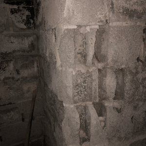

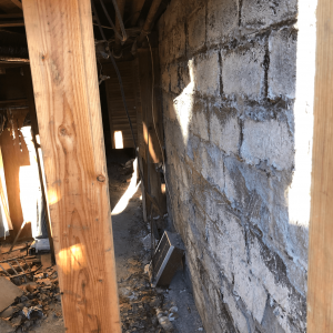

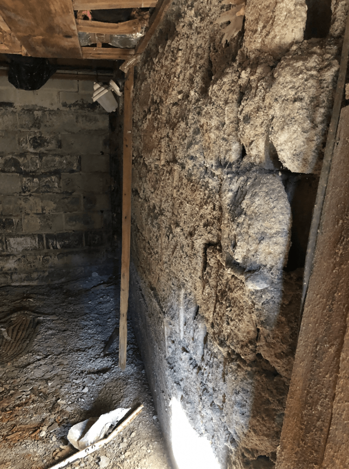

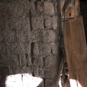

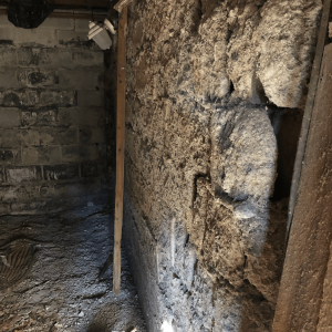

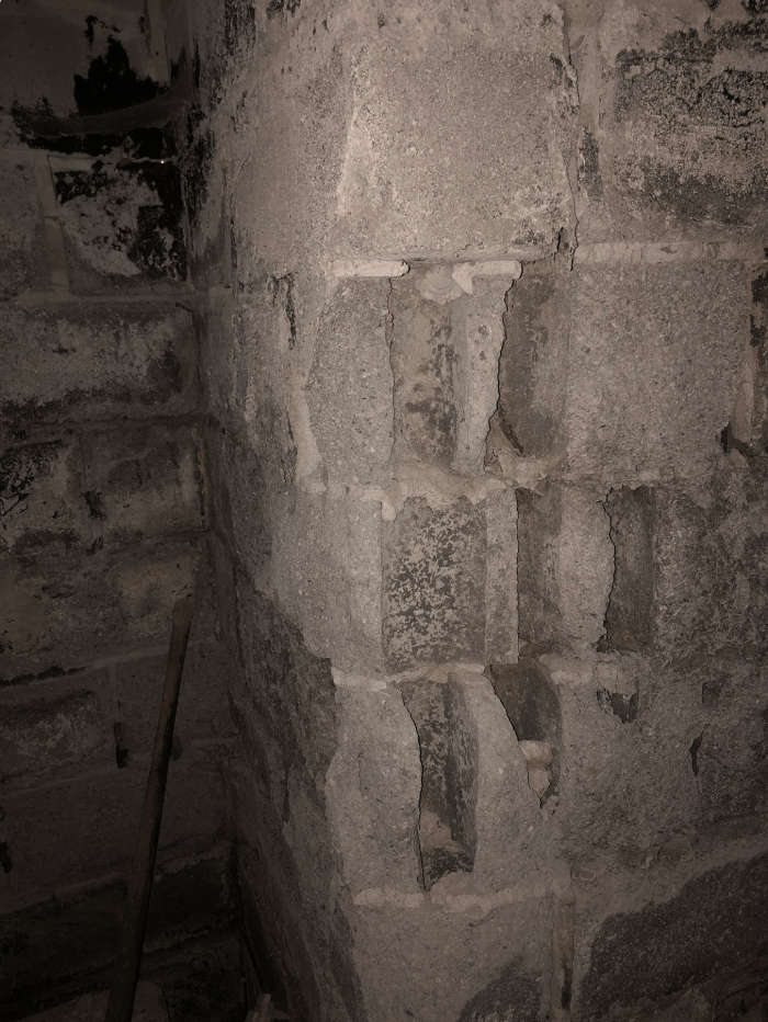

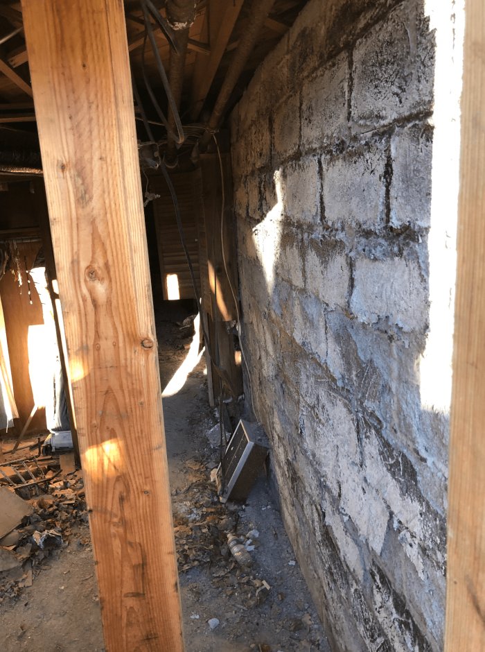

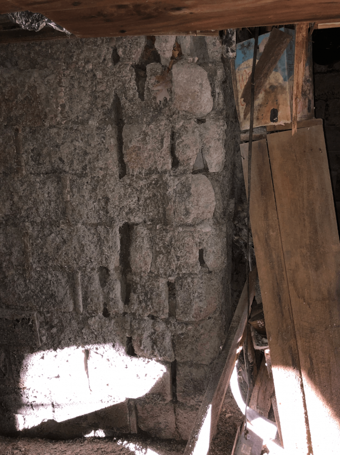

I own a 1920 home in New York (Hudson Valley). The home hasn’t been lived in for at least 7 years (don’t know exactly). It has some big issues! Most notably – the foundation. I’m in the process of getting inspections + quotes from local foundation / masonry folks. The goal is for this to become my primary residency. My budget isn’t unlimited, but I don’t want a cheap flip / bandaid solutions either.
Some details:
1. Home has a full basement, walkout on one side, with about a 1300sqft footprint. The foundation walls are concrete blocks. Lots of corners – it’s an odd footprint.
2. The home is currently on supports as a previous owner was replacing one of the foundation walls. I’ve inherited an in progress job with *very* little background info, unfortunately. about 100ft of wall is open & partially rebuilt.
3. Some walls are noticeably bowed. All walls with earth on the other side are showing signs of deterioration. I can brush off not only surface, but chunks in some cases (see attached video).
5. There is moisture in the basement, but it seems to be exclusively coming in from above, through the decay (vs from between the foundation wall & footing). It wasn’t noticeable when raining, but the 2ft of snow that just melted off the roof made a noticeable trickle downward.
6. The issue seems to be lateral pressure & exterior moisture. The home itself doesn’t seem to be showing signs of vertical settling. The sill seems alright overall, minus a couple spots showing rot.
