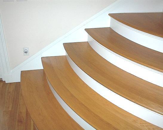

I'm not truin to ruffle any feathers here, but both of your pictures show a kickboard, not a skirtboard. technique to cut the kick is way different than that for skirt. Jim

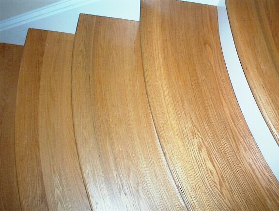

Those are some really beautiful treads and risers. The treads are bent right?
Ripped, planned, and laminated back together. Kept track of order for grain match.orientation.Red Oak at c. 3/8"
Your treads and risers but into the skirt. Correct?
Outstanding paint job, BTW.
Actuyally, on that one, I dadoed the riser and the tread into the skirt on both sides. It was a bit tricky, but tension will never be able to cause any creep

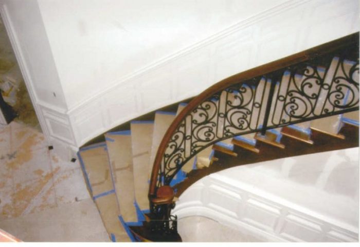

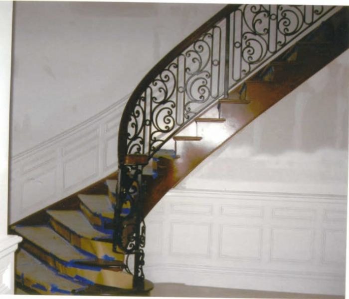

Here is a couple pictures of a curved stairway that I did and it has open ends.
We used a jig saw to cut the miters on the skirt board and cleaned them up with an hand plane. That is the miters where the riser meets the skirt board.
