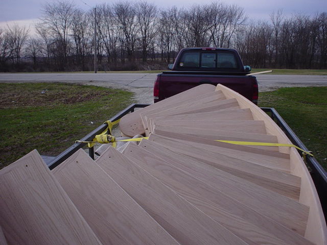

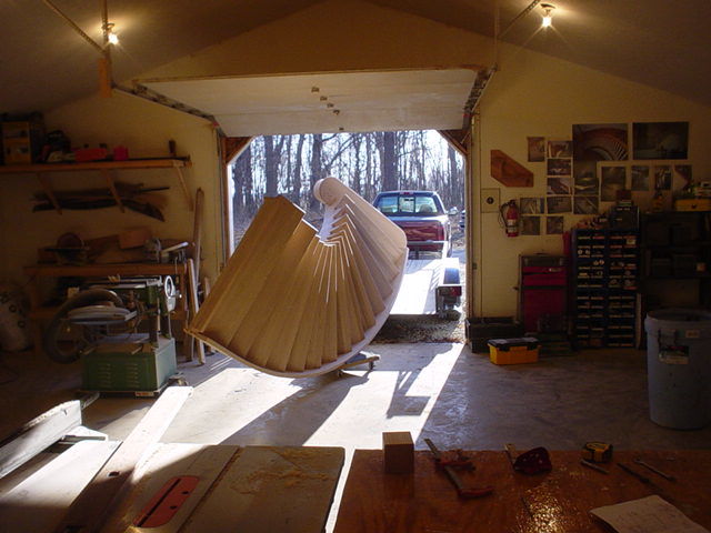

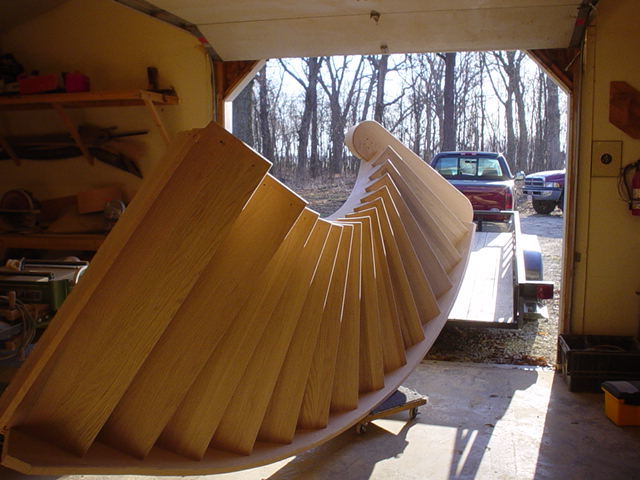

Here is a curved stairway that just hatched out of my stairshop today and on its way to its installation.
The pictures show the stairs in my shop, rail being glued up..and the stairs on its way outside my shop.

How do you get a curved stait into the house? I'm guessing not through a standard opening? and how many guys to lift/hoist/push that sucker into place, looks on the heavy side
Cag: Most of my curved stairways go right through the front door. In fact...I can get most curved stairs through a 2 foot door if I had to by screwing it through. I just get a crew of 6 to 10 guys for just a few minutes to get it into the house. I then attach the newels and then we set it into position. I have never had any problems to speak of to date getting the stairs inside the house and having them fit properly.

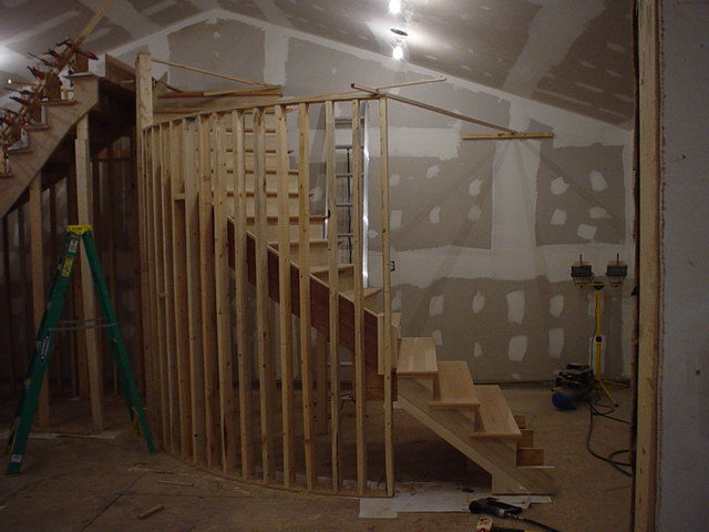

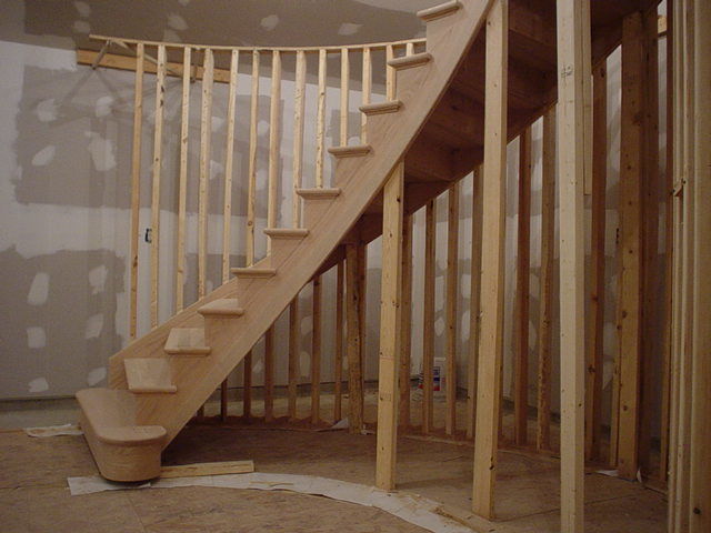

Thanks...whats interesting about this stairway is that the owner insists that it be installed "BEFORE" the drywall is hung in the house. I warned him about covering it up..moisture from the drywall mud...etc. It fell on deaf ears.....he is more concerned about having a stairway in the house. ......OH WELL...........
I will post pictures of it setting in the open stud foyer.

Do you do a mock-up of all the adjacent walls? What happens to the studs after the stair ships? The walls in the pics look like all new wood.
Do it right, or do it twice.
ELCID72:
I keep a bin of 8,10, and 12 foot 2 x4's for the forms. I use them over and over..only recutting the curved plywood plates. I am always using my form lumber for other purposes and I am always replacing these studs with new form lumber.

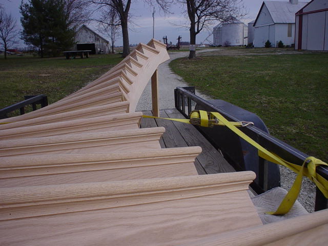

How do you get that little wheeled cart to stay under the stairs as you go down the road?

Mr. T.....Thanks for the compliments...that little cart just gets the stairway onto the trailor..then I lay it over for transport.
Stan, how dead-on do your mock-up walls have to be? Do you have any margin for error there? If not, your field measuring skills must be second to none.

When I receive a contract to build a set of circular stairs I also furnish the curved wall plates for the building. First I make a master template using a trammel bar router setup, then I duplicate as many sections as necessary on the shaper. I make two identical sets, one for the building and one stays in my shop. In most cases I will also install the curved wall framing to insure I have two identical walls giving me a better chance that in the end everything fits as opposed to the "close enough" framing concept..
Homebaseboston.
I layout the curved walls onsite and suppy a trammel guided routed plate for the walls. I then reproduce the foyer in my shop by making a like set for my curved stair forms with the radius of these reduced by the wall thickness. If it is typical drywall..then this is 1/2 inch less radius. If it is plaster, then this is 5/8 inch less..sometimes 3/4 inch depending on the plaster contractors specs.
I absolutely love staying in my shop and building a curved stairway knowing with confidence it will fit.
Almost every curved stairway that I deliver is met with severe doubt that it will go into the house though the front door and then after all that.. actually fit against the curved walls. That is probably my only part of curved stairbuilding that I dont care for....putting up with pessimistic people with all their negative thoughts. I have to blank it out and just DO iT. After the stairway slips into place..the reaction afterwards is my favorite part of curved stairway building. I dont know how many times I have heard words to the effect..."How do you figure this out to fit? The answer is just careful thought, measuring, and building the stairway in such a way as to guarantee it follows the exact desired radius.
When I set the stairs..I lag to each and every stud with 3/8 inch lag bolts. Construction glue is applied to the outside stringer so as to assure a good solid bond to the wall.
I have NEVER had to apply trim to the curved stair stinger as of yet. I set that stairway today in the house without any drywall applied...YIKES......OH WELL.....I told him to get it covered up with a tarp and not let anyone on it at all. Anyway...in this case the contractor is putting 1/2 inch drywall behind the stringer. I lagged each stud to the curved stringer with construction glue applied to shims that were cut to 17/32 of an inch. This gives just enough room for the drywall to slide in behind the stringer.

Here is a couple of shots of the stairs on my trailor.

If the stairs is set before the drywall is applied, I cut some 17/32 inch spacer blocks and use them to space the outside stringer to the studs. 1/2 inch drywall slips down into this space perfectly. If it is a plaster wall..I check with the plasterer to see what thickness his wall will be...usually 5/8 to 3/4 inch.
