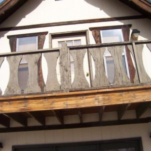

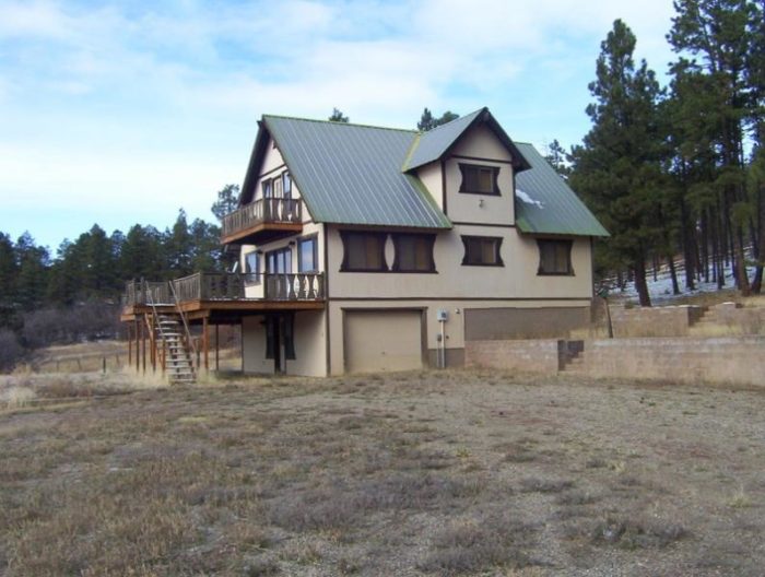

Looking for some input on a rail design for this house. Other than a variation of a 2×2 system. Retired couple, budget concerns of course.
Couldn’t find anything on the web.
Don’t think I could match existing as I doubt I could find 1×12’s that would hold up, at least here.
John

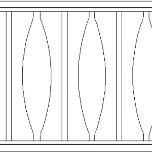

          You say that the prob is you can't get 1x12 material.  How about something like the attached sketch? It would use 1x6 or 1x8.  Looking at your location, maybe cedar?

            any chance those existing boards could be pulled, lightly planed, liberal use of a wood restorer product, and then reinstalled and painted?????

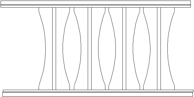

    Here's my half baked idea
    Those gaps are greater than 4" so that needs to be corrected.
    using the theme of that arc that replicates in the casings is a good idea
    So I would cut those same pattern from sheet goods, and do the layout in the sheet so that you are saving the off cut between the pieces for use
    Then do the install so that you have alternating male/female of the cuts, with about 3-1/2" to 4" spacing
    For sheet panels use Azec or 3/4" MDO both sides finished.
    Less waste, same basic design, and safer than current, not rot prone.
  4. Piffin | Oct 31, 2009 04:42pm | #10
    I might even paint the male/female slats alternating colours - say brwn to match current on the main slats, and cream to match the siding on the waste infill pieces.

    Hi John
    It wouldn't be cheap, but you could reproduce that shape in 1x12 Pvc trim
    Handy Dan
  7. glenaspen | Nov 02, 2009 01:58am | #20
    Just a thought but instead of 1x12's you could use 1x6's, cut the pattern on one side but with less depth so you could remain under 4" at the widest point, and then put a gap between the straight edges, anywhere from 1-4". It would still carry the theme of the window trim without the need for wide boards.
