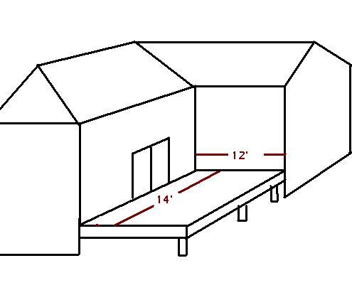

    Why can't you run the ledger the 14' way and run the joists the 12' way with no center beam?
    At the end of the 12'joists you make your girder the box which would run the 14' way by doubling or tripling up sitting on three footing and keeping it flush at the top and use joist hangers.

      2. Framer | Aug 11, 2006 05:40am | #12
        "The 14' way has a 6' patio door that opens to it."Why would that stop you from running the ledger that way and the floor joists the 12'way?Joe Carola

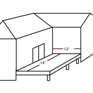

      3. Framer | Aug 11, 2006 05:48am | #13
        Is it something like this?Joe Carola
