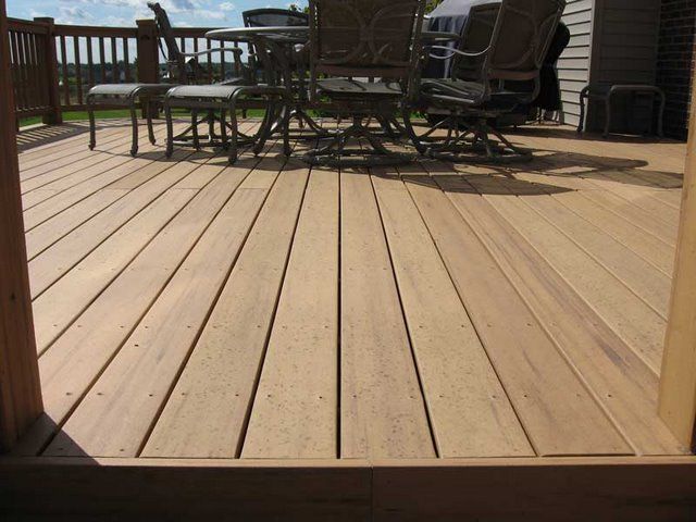

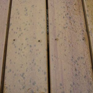

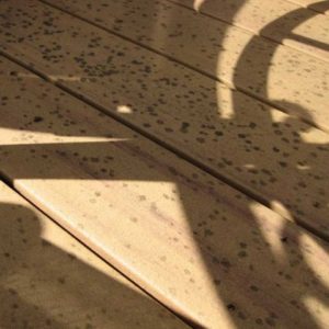

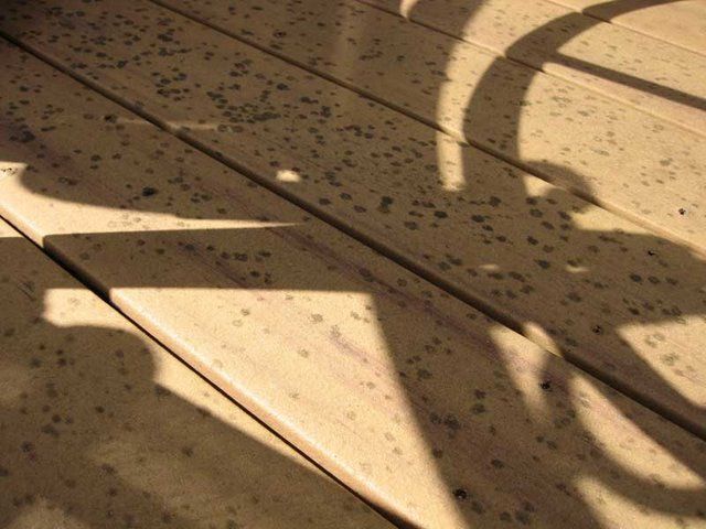

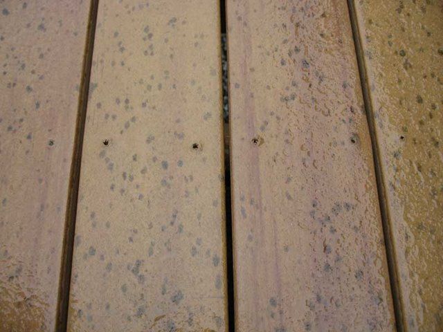

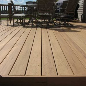

      I've been researching composites (trying to get away from using ipe all the time) and it seems like Trex still hasn't solved the mildew/mold issue that alot of the composites still have.here's some Brasilia .. I don't like it for another reason, and that is it's thin outer coating 'skin' can get scratched pretty easily from what I hear.EDIT: had to add, I got those Brasilia images off of a Deck Forum.
