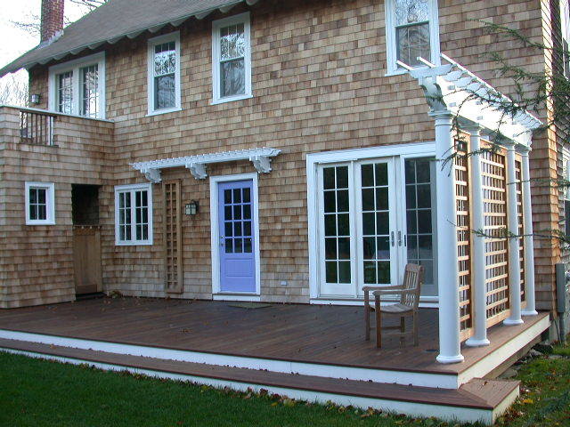

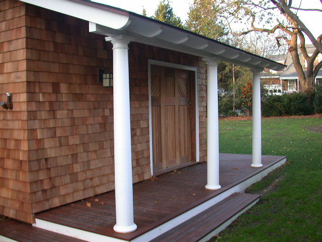

here's an ipe' with an outdoor indoor shower grate...
and a RC privacy screen.... with some uplights being cut into the declk for dramatic lightingMike Smith Rhode Island : Design / Build / Repair / Restore

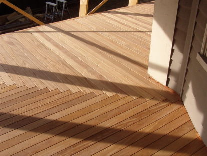

I just did my first Ipe deck (rebuilding a porch). It was a joy to work with, not really that hard (yes, pre-drilling was a pain, yes I snapped a few stainless screws), but all in all it was well worth it. Paid around $2 a square foot for 1x4 - delivered. (I did a lot of shopping around - ended up at Downes & Reader in Stoughton MA - very happy with them). Check out photo - can barely see fasteners when standing on it, and I haven't even filled the holes yet.
I have no idea what Trex and other synthetics cost, but I guess you have to add in for more robust framing. Certainly not the case for Ipe - this stuff is hard as a rock.
elegant , Bill... that's the corner detail i wanted to use...but the architect and owner overruledMike Smith Rhode Island : Design / Build / Repair / Restore
Great job Bill I like the herring bone patern......"Rather be a hammer than a nail"

Phat you can't get a much better review and illustration of decking materials in the wild than you have here great photos/design by Bill & Mike herringbone to lattice screens to grates presto
and as Pro dek says trimbutcher your belt sander will take those plugs down faster than you can imagine

again thanks for those pics Mike is that a profin type finish on your privacy screens

Mike & Bob - Thanks for the feedback - coming from you guys it means a lot. The herring bone was inspired by FineHomeBuilding #106 (Furniture Grade Deck). I think the thing that made it work was getting a carbide roundover bit to make the ends of the boards exactly match the existing round over on the edges.
I haven't encountered any slipperiness (yet) - I wonder if it might relate to the choice of finish? Mine is unfinished right now - still pondering what to do there. A good general question for folks out there might be this: how is your Ipe finished, and is it slippery? Maybe there's a correlation to a particular brand of finish (I'm considering Penofin or TWP). I HAVE noticed that if you get Anchor Seal on the surface, it's like grease when wet, but that's easy enough to avoid, and has nothing to do with the Ipe.

Mike - I forgot to ask - how did you secure the columns to the deck? There's no visible sign of fastners in your photo. That's the next step in my project, once the weather breaks. Thanks, Bill.
the ones supporting the roof have solid blocking . posts under the Ipe'... then the PT plug is screwed to the deck and the column goes over & gets screwed to the plug..
the ones supporting the Pergola / screen slip over 4x4 buried 4' and framed to the deck...Mike Smith Rhode Island : Design / Build / Repair / Restore
