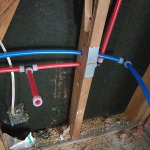

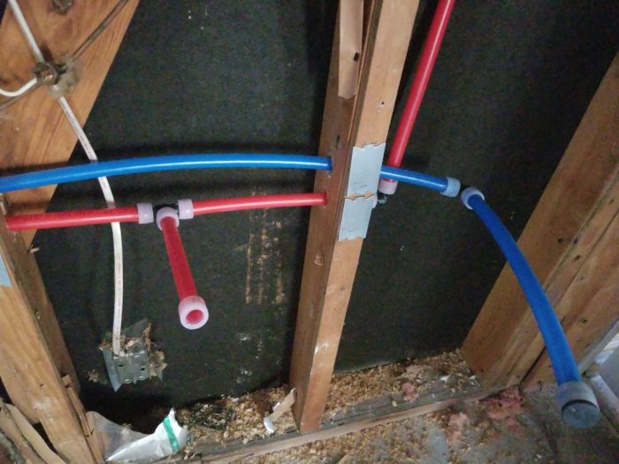

I’m running Uponor Pex lines through my house.  I’m wondering if I need a backing plate where the lines are terminated for sinks and toilets? Or can I just have them hanging like they are in this picture?
It seems like the lines are plenty sturdy and I’ve read its good to have a bit of slack in the lines.
I’m very new to this and was wondering if this is okay? or will I have issues with the lines rubbing against the frame due to hammering or banging noises once I put the drywall in?
Thanks!
  1. catmandeux | Jan 04, 2021 10:37am | #1
    Not OK. Any termination should be firmly supported.
    Lots of options available. Some examples: https://www.youtube.com/watch?v=gImV46bxvdU
    You can also use the usual copper / brass fittings with an adapter.
    What is the plan for the shut off valve?
    Make sure the lines are separated, and secured so they don't rub.
  2. EvanLarsen | Jan 04, 2021 10:58am | #2
    I have Uponor shut off valves. So the pex runs right to the shutoff valve.
    What would happen if they are not firmly supported?
  3. mikemahan3 | Jan 04, 2021 11:04am | #3
    What's the deal with that electrical cable in the picture? It seem to have some kind of T fitting in it.
    1. ktkcad | Jan 04, 2021 01:41pm | #5
      It appears to me to be passing through a hole to the other side of the wall there.
      unclemike42 | Jan 04, 2021 01:46pm | #6
      This looks like a bonding wire on a large cable, which happens to be in front of the NM cable
  4. catmandeux | Jan 04, 2021 11:29am | #4
    PEX moves with pressure and temperature changes.
    If not anchored, the trim will be sliding around scratching up the wall finish.
    If the hole is not large enough for the motion, the PEX will wear on the hole edge.
    Any abuse of the stub out is transferred to the hidden fittings, potential hidden failures.
