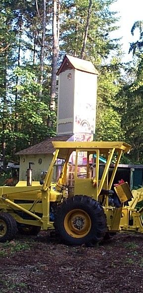

Or , build your pumphuse with a tower and a permanently installed winch. Winch pix later today if you would like.

I've been to the top of that tower.You can see all the way from Texas to Narnia from up there.
