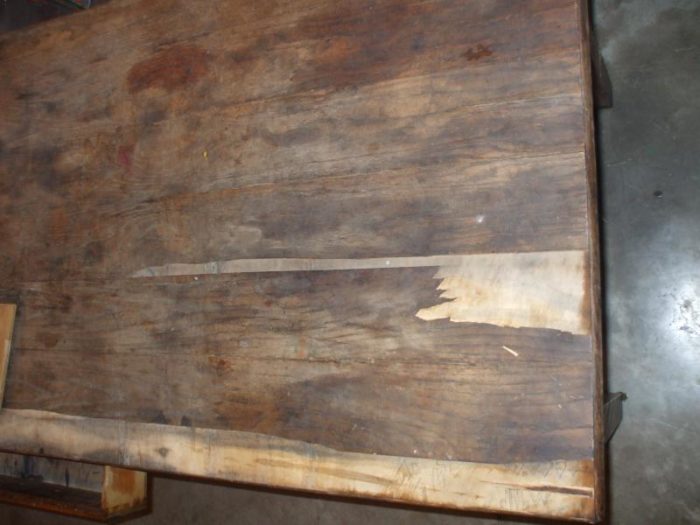

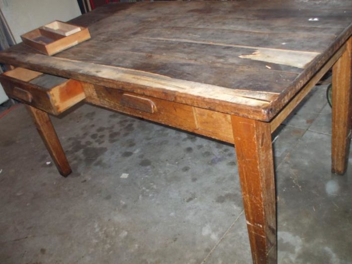

just picked up an old table/desk (free from Craigslist). I’m going to use it in my garage as a work table for stained glass, so I’m not looking to refinish the entire table. the top is made of oak veneer plywood, looks like it may be very early plywood. 1 1/4″ thick, the core is soft wood and the outer layers are 3/16″ oak veneer. it’s not a full sheet of veneer, but 6″ wide strips. i want to strip the veneer from the top, paint it and then use lacquer or epoxy for a finish. anyhow i have 2 q’s, 1st, has anyone seen plywood like this? 2nd and more importantly, opinions on lacquer vs epoxy ( remember this isn’t a fine piece of furniture). where can i get the lacquer and or epoxy? i assume lowes, hd don’t carry it. i live near Chicago.

you should resize those pics so all can see. i opened them and they were blurry anyway, so I am not sure anyone will be able to see what you are describing.
You want to strip the veneer or the finsih from the veneer?

most of the veneer on the up side is warped and lose. top looks pretty straight. do you think it will effect it that much if i took the rest of the veneer off? will the epoxy help stabilize it? i just like the look of the lacquer/epoxy. also there is a piece of trim around the edge of the top to hide the edge of the plywood, i need to make up the 3/16" for the missing veneer.
It's notreally ply wood then..it's a lumber core panel with oak face and maybe a lesser qual. balancing sheet on the bottom. Pretty common actually. Many I've seen or dismantled had CHESTNUT as a core, remember, way back when it was a secondary wood due to it's plentifulness.
I've had the face veneers get wet and curl off, ( Hide Glue) and wind up with a still nice top...but the grain matching or quality of figure is never considered, so it may be ugly.
Belt sand it to get the old whatever off, maybe try a scraper first if it gums up the belt. It probably is shellac, and a good drenching with alcohol soaked rags will dissolve most of it.
Then paint away if thats your desire.
i want to strip the veneer, paint the substrate, then lacquer or epoxy. hopefully these pics are better.
Let's try this:Looks like an old library table. The legs taper inward which seems a little odd to me, they usually taper out at the bottom.

That'll lift off witha wide putty knife , maybe employ a hot iron to melt the hide glue. Or Mucilage. DO NOT use the wife's GOOD Iron. Go to goodwill or salvation army and buy an old clunker.Spheramid Enterprises Architectural Woodworks

Looks like a nice table. How about replacing the damaged veneer with another?
6bag, I have that same table, found it left in a rental. Inside the drawer has a tag "Desks Inc NY." I had it sitting in the wood pile, and one day I used refinisher to strip the old finish and the old thing just came alive! The veneer is a gorgeous quartersawn Oak, but is really thin, so it cannot be sanded. Too bad yours is beat up so badly.
well i think i know what to do. attach a new piece of 3/4" BC plywood to the top. that way i have my work table, and i also have the option to refinish it some day. i really do like the lines of the table, and would like to have it in my house some day.
Thats the best idea yet, it is a nice table.
What you could do is run the new plywood larger that the current table top & fasten cleats to the bottom of the new plywood & place it over the old top, it will keep your work top from slideing & not leave any holes in the old top for later repairs. No one should regard themselve as "God's gift to man." But rather a mere man whos gifts are from God.

I did look at the other pix 006.gif and noticed the thick edge banding on your table. That is different from mine. Is the top veneer also 3/16 inch?
