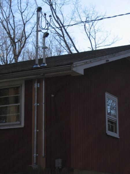

In the Northeast, there aren’t many one story hip roof homes. But I am going to be converting a gable to a hip soon, and that means a change in the way the elec service attaches to the house, as the new attachment point will be too low..
Now, the service has always been low, and the cable and phone lines were below code. A driveway parking extension will be going under the lines, so it needs to be addressed.
In January, a tree fell, and took the lines down but somehow all sevices remained functional. Knowing that I was going to move the sevice entrance I called the electrician on the job, and we installed an overhead service conduit that runs thru the soffit, at the corner of the house where we won’t be working, thru the roof and terminates above the roof with a rain cap. The power company finally got out and connected to the new entrance and new meter box. So far, so good!
When we installed the service conduit, we also installed a second 2″conduit for low voltage, a rain cap and insulating strain relief anchor. The idea was to run the phone and cable down this second 2″ conduit to their respective terminal blocks.
But there’s a catch…you knew there would be! The cable co will not share the conduit with the phone company, nor will they “snake” the counduit, LOL…all 15 straight feet of it! (Like they even have to!) They contend that if the phone “goes down” they don’t want to go with it.
I need to call the phone co. and see if THEY have an issue with sharing the conduit with cable. If not we just run the cable first, LOL. and thats that.
If they do, I guess I need a THIRD conduit up there! ARRRGGG!
So the questions are: Is there a smaller roof boot than 2″?? No need to run a huge counduit up for ONE wire…
What are the IRC codes that I need to be aware of? As this is work resulting from storm damage no permiting has been done but I want to be sure it is code compliant, of course. I thought I was fine, and that we were improving compliance by getting these things more than the 12 or so feet off the ground they were to start with.
I will add a pic tonight when I get home.
Any advice would be much appreciated!  Thanks!!!!
(I shoulda dug a trench, LOL)

  1. Lateapex911 | Mar 01, 2006 03:39am | #1
    Well, after some research it looks like a third conduit must go up.
    So it's bit simpler but I am still having a tough time finding any information of clearances that I need maintained between the hi and low voltage wires.
    Any ideas?
    And......do the make the roof "boot" thing in anything other than 2"? I'd love to siamese a 1" right next to it.....
