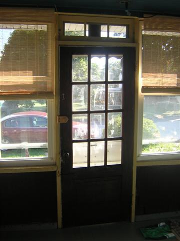

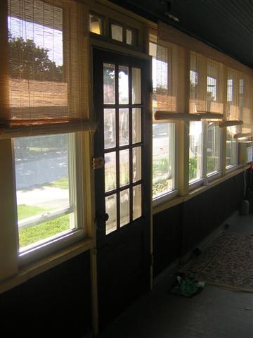

I have (hopefully) attached two photos. I am open to any suggestions that don't involve a a second mortgage and/or a wrecking ball.
Jason
jason.... this
could easily be reframed
both side windows could become sidelights and some solid wall
or the windows could become solid wall
the transom light over the door could simply be eliminated and provide the space you need for a header
the only problem i see MAY be what it will look like on the exterior
maybe you can post some pics of this elevation on the exterior
what is your siding ?
Edited 8/13/2006 8:51 pm ET by MikeSmith
The exterior is vinyl siding. The framing around the door and windows was wrapped in aluminum when the siding was done. Cutting the siding wouldn't be too bad, but I would think all the white aluminum trim would be a pain.
Jason

well.. if you wanted to increase the comfort level in that room , you could reframe the door and the flanking windows, and insulate the open studs
then develop a program of replacing the other windows with vinyl replacement windows with insulating glass
it will be easier to heat and cool the room...
i would bet the windows precede 1978 , so they may have lead paint... a replacement plan would also help with reducing that exposure

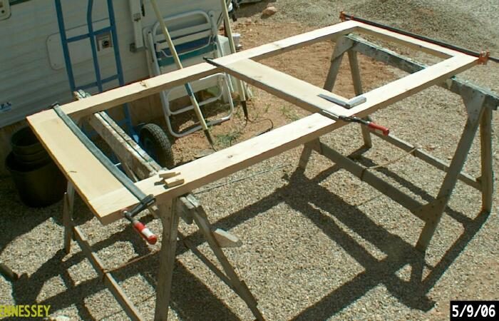

If you make furniture you can make a door.
You need some decent material for the rails and stiles, panels can be whatever you like.
Two rails with good sized mortises, 3 stiles fairly wide with wide tenons keep it flat and no sag.
Set it up for assy on 2 saw horses, string from corner to corner diagonally will tell you when it's flat. Shim the horses or door itself to flat.
Panels are the same as what you'd build for a cabinet door.
It's ain't rocket science, here's my outdoor door shop with a screen door going together.
Biggest problem here is the non availability of lumber to choose from.

Hey Joe--I like those folding hosses
They've seen a lot of use.
1x3" fir with ply gussets & piffin screws.
There's a pair of cabinet hinges at the top & a piece of light chain at the bottom that keeps them from opening too far. Weigh a couple pounds each & lay flat.
They'll hold a lot of weight, I haven't tested them to destruction yet.
Joe H
