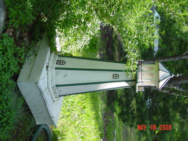

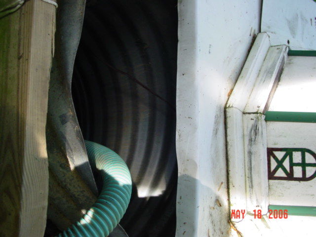

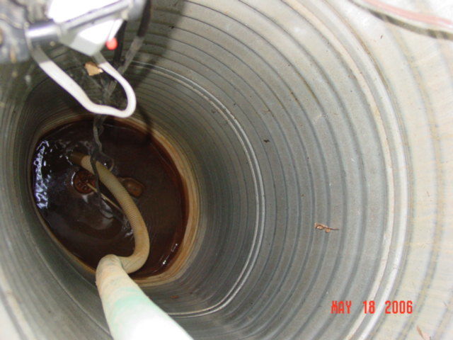

I did the same thing about 10 years ago. Dug out one end wall of the house, re-parged it, tarred it and put two 4" perf pipes to a dry-well/sump pit. I used a 10' section of culvert pipe standing on end to get to the bottom of the pit where a sump pump is located. I left a short ~18" section above ground, built a simple stand over it and set a decorative 5' lighthouse on the stand to hide it a little. That has worked well for us, the basement wall has remained dry. If I can figure out how to post a pic, I will...Hope this helps.

Here are a couple of pics....
The culvert pipe looks like a good way to go. How did you do the bottom?
The hole where I put the pump was about 2' lower than the wall footing and the perf. pipe runs to this level. I put some 2" stone at the bottom, probably about 1' deep. Then I put 3/4" stone on top of that - maybe 4", this is the same 3/4" that I was using to backfill against the wall. The pump simply sits on top of the 3/4" stone. Someone later suggested that I should have placed the pump on a block so it would stay out of any mud that accumulated. Although when it is dry down there I can still see the 3/4 layer of stone and no mud accumulation yet. This is after 10 years so in my case it seems it may not be necessary.FWIW - I also read a few years later on a thread that I should have used round gravel for backfill against the wall rather than the 3/4 stone. I can't remember exactly why but I think the reason was it didn't compact as tightly and provided better long term drainage. The 3/4 stone is what is commonly used in this area by builders and I didn't know enough to use anything different.
