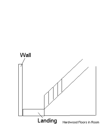

My husband and I need to decide how we will finish our stairs. It will be a straight staircase against one wall but open to the room (with a railing) on one side. (not your typical dramatic foyer staircase, just a standard one at the edge of a room See my attached pictures (The first one’s rough, I know, but I just drew it up quick (and obviously it’s not to scale).
The floor of the room will be hardwood (not pre-finished). The upstairs hallway (where the stairs lead) will be carpet.
We do not want to do plain hardwood stairs because they will be slippery. We’d really like to do hardwood stairs with a carpet runner up the middle. If we did that, how would we deal with the landing? Would the runner turn and also come down the last step our into the room? Or would it just continue straight and end at the wall?

Generally speaking, fully carpeted stairs will cost the least. But you knew that.
Hardwood stairs are built from hardwood components. Treads, risers, skirkboards etc. Some of these can be a slightly lesser grade if they are painted. Painted risers for example. They are not covered with strip flooring. Except for the landing.
A carpet runner can be installed over these stairs, leaving the ends exposed.
Fully carpeted stairs are generally built from construction type lumber and then covered. Hence the price difference.
The reason your framer is asking now is because they cut the stringers based on the thickness of the treads. Hardwood being about 1 1/16 vs 1 1/2 for construction. So, yes, he will build them differently. And yes, you will have to rip them out later to do wood.
If it was my house, I would do a hardwood landing and fully carpeted stairs above that. I would spend the money on a nice railing, newel and balusters. The things you would see from the living room. Hope this helps.
I would argue that the hardwood stairs with a runner would give you the best options for the future. As you know, construction grade wood under wall to wall carpet would mean rebuilding the stairs if you should want hardwood treads. Stairs get a lot of use and the wall to wall stair carpet wears out -and looks ugly - sooner than you might want.
The runner can be anchored with a rod and two screw eyes at the back of each tread, making replacement, or just removal quite simple. Runners can cost a moderate amount or thousands depending what you select. Your house looks to be a colonial style so I'm guessing a runner would be a classy addition. I would install one runner from the living room floor up and across the landing. Then a runner from the base of the riser that meets the landing up to the top of the stairs.
If you eventually want hardwood treads and/or a runner it,'s a pay-me-now or pay-me-later deal. Later will cost more. I'm sure it will be expensive now but your framer should have a name or two of someone you could ask. Any carpet store should be able to give you the name of a stair builder. Do hardwood stairs now with a reasonably priced runner and replace just the runner in a few years.

Do it in hardwood, now. Decide after you live with it a year whether you want to do a rug-runner.
Leave the landing hardwood, of course. Have it match the adjacent floor one step down.
And of course, do the step treads in the same wood species as the flooring.
Carpet on stairs gets old real fast.
And, finished wood treads are not slippery. Think of how often you see hardwood stair treads. They are ubiquitous.
Slippery is ceramic tile in bathroom floors. Wooden stair treads are classic.

It is doubtful you will find a good finish carp to come out and JUST do the staircase (unless it is one whale of a staircase). The time to move in would be as long as the actual construction time.
The landing? That is a matter of personal taste and function. Personally... I stop the runner at the end of the actual stairway and do an inlay on the landing. But then again... inlay might be a bit much for someone who is just learning how to work with hardwood floors!! LOL

If I recall correctly, you're designing the house as an "updated 1840s farmhouse"? If you were doing a reproduction 1840s farmhouse, a venetian carpet or an ingrain carpet would be appropriate, but in any case, it's a look worth considering.
Here's a couple links of newly-installed stair runners.
http://www.ingraincarpet.com/ingrain008.htm
http://www.ingraincarpet.com/ingrain007.htm
These examples appear to be painted treads and painted risers, but varnished treads and painted risers is also a classic look.
There's one shot of a landing, but I can't quite make out how they handled the carpet. But it seems like the carpet should continue onto the landing, and end at the floor level ...
