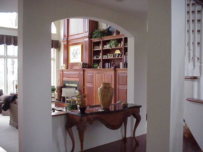

Found some pictures of some cabinet work I did for a client a few years back.
Have a good new year

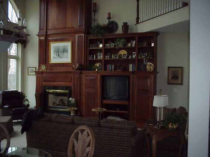

Wow! That's gorgeous! What kind of wood is it? It looks like cherry but I can't tell if there's a stain on it. Beautiful work!!!
It is mahogany it has a stain on it I can't recall the color but it did not darken it much.

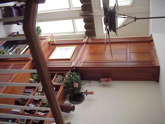

I made most of the moldings to match other millwork profiles in the house with my w&h molder. The raised panels over the fireplace in the center are over 4 feet wide and they have remained stable.
I will try to post the library wall I did in the same home.
Really nice work. Truely - "Fine Homebuilding". Be proud!
Thank you, the other peoples homes get done before my own.

The piece is large without being overstated. Very elegant, everything looks as though it belongs, nice balance.
The customers must have been very pleased with the final result.
Beautiful work.

The customers were one of the nicest ones I have worked for, and very patient also.
Did you pre-finish the panels or do you have a spray guy?

All the panels were stained and finished with 3 to 4 coats of waterlox oil finish.
Is this it?
Sprayed or brush finish?
Waterlox Oil-Modified Urethane - Gloss XL-88 Product Number: TB 4252

Hand applied with a rag ,tb6031, wiped on, this should be the link.

VERY nice work.
Creative photoghraphy as well in the last shot!!

I do somewhat similar projects (usually on a much smaller scale), and have a real problem designing to the code requirement for 12" separation between the fireplace opening and any combustible materials. Was that an issue on this job? It looks like you have about 6" - 8" of clearance.
Anyone figured out any neat ways to deal with that? - lol
It has been a few years since I built that so my memory is a little fuzzy. The black granite surround was installed before I started my work. The clearances were close to code if you measure from the firebox, also it is a gas fireplace that does not get very hot.
