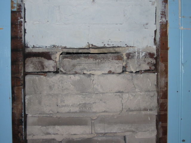

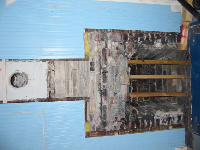

Today though, I took the mantel off the original fireplace, and a cover that hid the firebox. The previous owner covered the firebox because she said it was too expensive at the time to bring the flue and everything else up to code. Anyway, I wanted to change the mantel she installed and look at the possibility of putting in a gas log . However, as you can see from the attached pictures, I found the fireplace in appalling conditions. Yes, those are pieces of wood holding up the bottom courses of bricks.
I rumaged around and found a picture pre-renovation. It turns out the original fireplace had a brick mantel – the previous owner had demolished it, and, from the looks of it, weakened the firebox and possibly the chimney. Much of the chimney is exposed on the second and third floor and it is in good condition, so the damage seems confined to the first floor.
Ok, I’m looking for comments and suggestions here. I am planning on having a Mason come and look at it, but I’d like some other opinions. Is it remotely resonable to repair this, or will the whole thing have to come down? I know this isn’t a legal forum, but do you think I’d have any recourse against the previous owner as she is the one who did the damage (and obviously did not disclose it to me)? Any other comments would be appreciated.

Fireplaces are ugly when the the mantle is removed. I have seen a lot worst situations where the firebrick is falling out. I looks like someone trid to patch and repair. Since your not in eathquake country the repair are more cosmetic than structural. If the fireplace is rebuilt by a real chimney guy, it should be good for another 100 years.
The wood looks like it was place under the metal ledger, if the ends are supported by bricks and there is a metal ledger, it should not fall.
I see no court case, if it was blocked off the previous owner never implied it will work. Build a fire now, it will work (if you put a glass fireplace door), but it looks like crap.
Replaceall the firebrick, grout between the firebrick and chimney bricks, install a new legder, install a new mantel/Face and you will have a fireplace that's better than it ever was originally. Cuz you may find the chimney was never grouted, no steel and todays motar is stronger.

I'm not up-to-date on codes, but from what I remember I think there are some real issues there. Does the chimney have flue tiles in good shape? If not, they're gonna need to be installed. I think current code requires fire clay be used. btw the tiles. The framing looks too close for 4" chimney wall width. Think that typically needs to have a 2" airspace to framing. 8" wall width I think can be butt up against it. Looks like a stove opening above - that needs to be sealed up.
From the pics it doesn't look like there's room for a real smokebox (the area btw the firebox and the first flue tile). Looks to me like only about 7c above the opening. Now, the firebox is narrow and deep, so you might be able to get away with that from a draw standpoint, but I'd bet the bricklayer's gonna say something about that also. I would not want the current setup you have. Is there a damper? Not even sure they're required by code, but I wouldn't have a fireplace without one.
The bricklayer's gonna be able to help you more than I can from these pics, but I don't think it's a "point 'em up and fire it up" job.

There are no flue tiles in the chimney, it's all just brick. I don't think there's enough room to put tiles in, andy the chimney actually makes a bend in the attic to meet the roof peak. It's pretty small too. I was hoping a SS duct would be sufficient for a gas fireplace, but I'm not sure about the code for that.
The box itself is about 31" wide, 31" tall and 19" deep at the base. The back slopes in toward the front, kinda like a rumsford.
Yeah, there is a stove opening/cleanout, which will be sealed - there are also cleanouts (I'm guessing that's what they are) in the second floor and attic. It definitely doesn't meet the airspace requirement, as a lot of the original framing sits right on the masonry.
There's no damper currently, but one will be installed.
Also, I don't intend to bring this back to be able to burn wood fires - mainly because it would probably have to be completely rebuilt. I just want to be able to put in a nice gas log. Fortunately, there is a vent on the bottom of the firebox for fresh air.

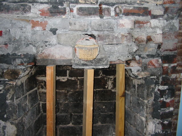

From the original photo it looks like the thing never drew right in the rist place - checck out the smoke stains above the firboxe opeing.
And what the heck is that round terra cottat tile doing sticking out in the middle of the lintel?
