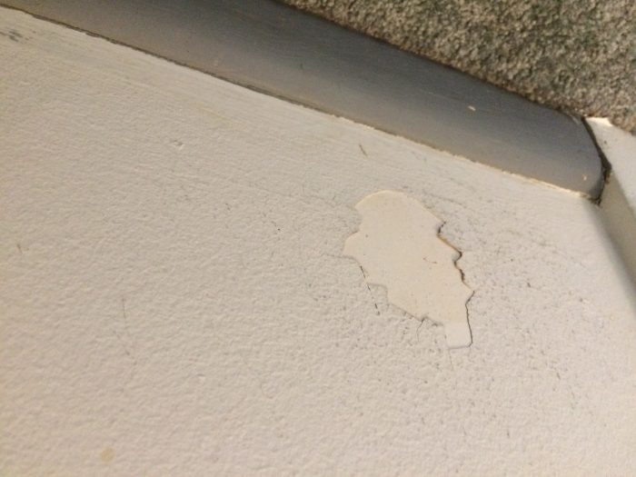

I have this problem, also. Same era of home in NE Ohio. In my house the paint was lifted all through the house a few inches above the base boards. I have just started working with it in the upstairs hallway and just noticed some peeling at the top of the walls. There are only 2 coats of paint then a very smooth plaster wall. When scraping it is very loose and pretty much seems like the whole wall will peel off easily. Could there possibly be lead in what I am scraping off?
The "plaster" does not have a hardness to it. I can rub it with my hand and my hand will be white with dust.
When I get this all scraped off will I need to still skim coat it? I'm don't know how to do that and would rather be able to paint over it with some type of sealer, if possible.

I think I have 1 pic attached, at least. I'll get a couple more later.
So many products out there. As I am still scraping paint, haven't purchased one yet. I was hoping not to have to skim coat only because my patience level is very low and I don't want to make a career out of painting a hallway. :( so I am trying to get all the paint scraped; not sure if I will be successful.
The more I think about the cause of this peeling paint and referring to the OPs comment I'm wondering if temperature differences caused dampness in the plaster although that doesn't explain the odd places the paint has peeled. What I am working on now is an interior upstairs hallway. I can somewhat understand the walls at the ceiling peeling because the attic was not originally insulated but why at the baseboards on interior walls? Nevertheless, I will be addressing this problem as I paint each room so want to learn the proper procedure because I seriously hate painting!
Regarding your first picture.....
Damp basement, clothes chute in that wall, was there ever wallpaper, what is the room on the other side, so all walls have that texture?
