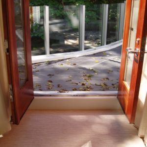

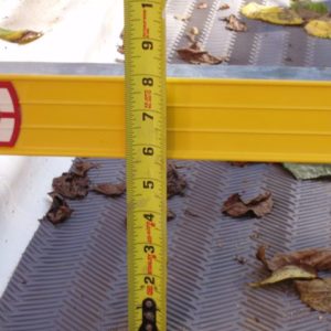

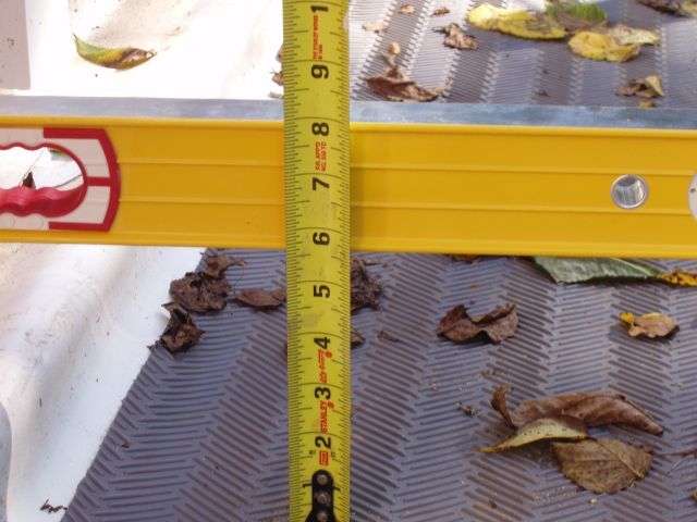

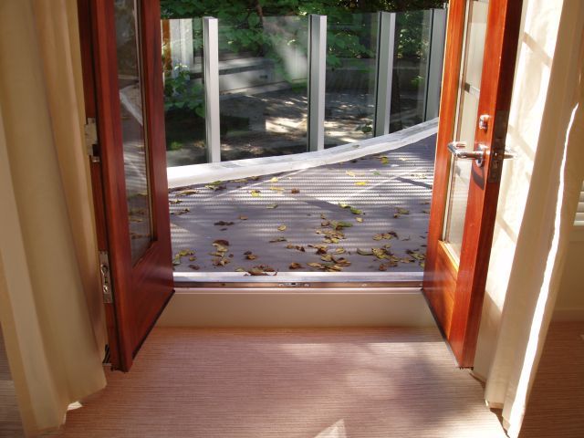

I'm curios what was the "walking pad" that was put over top of your PVC? Only thing I can think of is what is used on commercial roofs for access walkways to equipment.
Got any pictures?
I believe that's what it's used for. it was speced by the Architects on this job. These are the only photos I can find right now:
Barry E-Remodeler
That looks like interesting stuff. I've never seen it. It does look like it would hold a lot of dirt with the deep grooves. Might be hard to keep clean?
It,s only been on since last fall, so we'll see. There's also a coupla trees around the place that drop stuff on the roof.Be interesting to see how it holds up
Barry E-Remodeler
Thats exactly what i was thinking it was. Never seen it used for a balcony like that before.
On a side note: Ive never seen a curb that high for a door threshold. 6"?
Is that allowed by code?
"Is that allowed by code?"<G> That's why I took that picture with the tape measure. I had to email it to the building inspector so the whole office could debate it. There is more than a few emails flying back and forth between the BIs and the architects. The jury is still out. Here's the pertinent code we are dealing with:Exception: The landing at an exterior doorway shall not be more than 7 ¾ inches (196 mm) below the top of the threshold, provided the door, other than an exterior storm or screen door does not swing over the landing.
....The floor or landing at exterior doors other than the exit door required by Section R311.4.1 shall not be required to comply with this requirement but shall have a rise no greater than that permitted in Section R311.5.3. .......This door is off of a 2nd floor master bedroom and has limited access. This house had a lot of commercial elements. Right below this deck is a curved curtain wall. There are some photos in the photo section under "International Style Architecture" I believe
Barry E-Remodeler
Well I'd think your safe, but I've had to "argue" things that I was clearly within the code before to.
