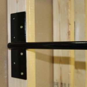

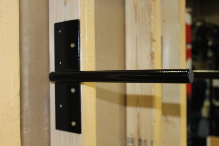

  9. andresrene | Feb 19, 2020 05:31pm | #10
    Try these Floating Shelf Brackets: https://rightonbracket.com/product/floating-shelf-bracket/
    the have a thick back-plate and are welded all the way through on the mount rods that come out.
    Or these Mantel Brackets: https://rightonbracket.com/product/fireplace-mantel-bracket/
    They mount to the stud and work quite well will super heavy stuff. Railroad tie mantels, stone or granite shelves, etc. See picture
