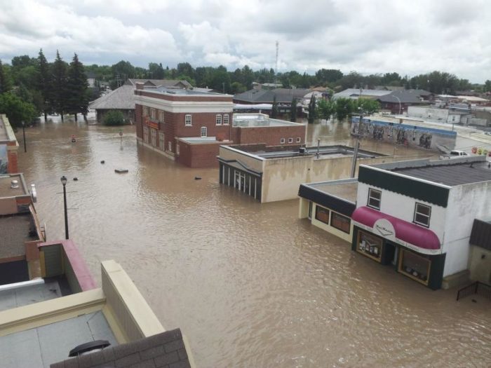

I am a small homebuilder in High River, Alberta Canada. I’m sure most of you are aware, but several weeks ago, over 80% of the 13,000 person town was flooded. Over 3000 homes with various degrees of damage.
