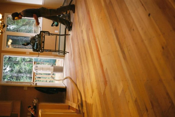

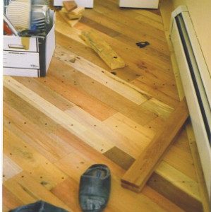

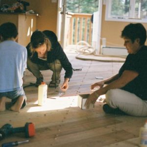

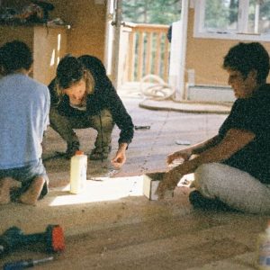

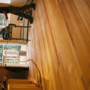

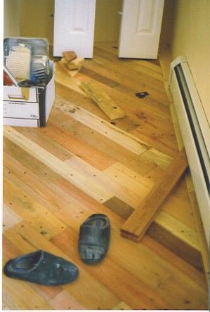

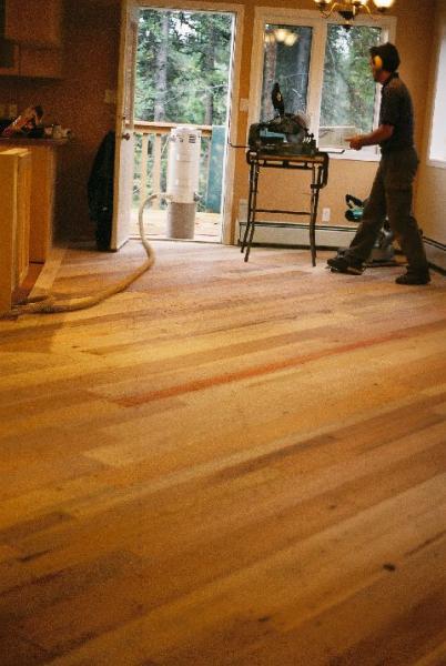

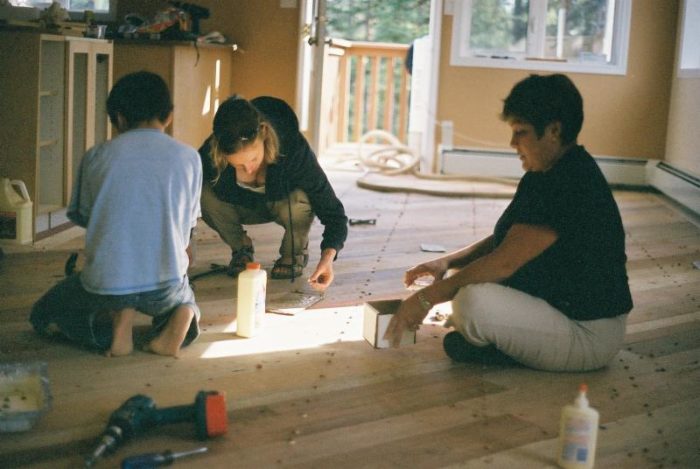

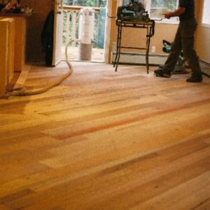

Hi All,
For about 3 years I have been collecting, de-stapling, de-nailing and stickering wood from crates. The wood is from Indonesia- at least that is what the crates say. I don’t know what 99% of the wood is but I call it “mahogany” because that is the only wood I can identify. This year my brother built a house and needed to decide whether to put in a decent heating system or put in flooring. I suggested we make the flooring ourselves from the “mahogany”- I had about 1600 board feet of it by now. Beautiful wood too! 7 ft long 1 inch thick and some boards 8 inches wide. We milled it flat and straight and then glued & screwed the floor into place. After 320 + man hours the floor is done. It was a lot more work than we bargained for. Putting everything on a diagonal didn’t speed things along either.
Anyway the Floor is FANTASTIC. Especially when the first coat of Varathane went on….
Better than we had hoped.
I include pictures of:
-the milling with crates in background
-close up of the unfinished floor
-a picture of the “plugging party”
I will include pictures of the finished product as soon as I get the photos developed.

  1. JohnSprung | Sep 14, 2005 01:33am | #1
    I love the look.  It sure beats the bland uniformity of Pergo, and probably the price, too.  Where do you get the crates?
    -- J.S.

      1. rez | Sep 14, 2005 02:10am | #4
        M-
        Go ahead and post a large KB pic and I'll shrink it down.
        That floor deserves a better look than that little pic in the corner ;o)

      2. calvin | Sep 14, 2005 02:58am | #5
        M,  Thanks for the plug party pic............and I mean no offense.
        Very nice job, the finish pics will be sweet.Remodeling Contractor just outside the Glass City.

  3. cynwyd | Sep 14, 2005 03:58am | #7
    did you use Miller dowels or steel screws and your own cut plugs or storebought
    fishdog | Sep 14, 2005 05:30am | #9
    nice plugs
    1. MStehelin | Sep 14, 2005 07:24am | #10
      You have a great eye for detail(s)!
