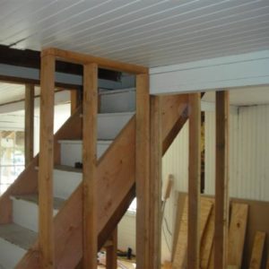

          Ok, I was afraid of this happenning.  I'll post some pics so you better understand the situation.  There is no drywall at all, 120 year old house.  Hold off on your answers until I get the pics up, probably tomorrow.
          Kevin

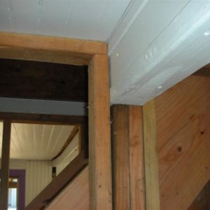

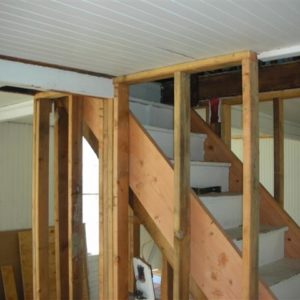

    2. dockelly | Jun 19, 2008 03:22am | #7
      here are some pics, better explains the situation:
      The beams right and left of the staircase will be supported by doubled 2x4's in the wall.
      1. danno7x | Jun 19, 2008 04:33am | #8
        Why is it you cant nail your wall to the joists running along the stair well?  It sounds like your enclosing the stairs with two walls right, joists parellel with the stairs.  A little explanation with those pics and youll have your answer from somebody.
        1. frammer52 | Jun 19, 2008 04:41am | #9
          The biggest problem I see is the stringers are directly under the floor joists.
          How were you planning to finish off this detail?

          1. danno7x | Jun 19, 2008 04:54am | #10
            I thought it looked like the floor joist was doubled in the pic because the ceiling is stagered back so far.  If its not I would cut back that ceiling to the depth of the wall slide another joist in there then a nailer for the ceiling (probably a 2x4 on the flat)then build the wall and fasten up into the new stuff.  It seems like ive done a lot more with a lot worse situations than this, it dosent seem too bad.
          2. dockelly | Jun 19, 2008 03:34pm | #15
            the stringers in the pics are screwed to the notched stringer that were there, I plan on building the walls about about 1/2 way so the last few steps are exposed.  Than I'll do railings for the bottom few steps, using the stringer for attachment, or do a bottom rail a few inches above the stringer, like on a porch.
          3. frammer52 | Jun 19, 2008 03:57pm | #16
            It appears from the picture that the stringer is directly under the above floor joists, that is why asking. if it is not follow Jimallen and Dovetails recomendation.
          4. dovetail97128 | Jun 19, 2008 05:15pm | #17
            I just looked again at the photos and believe you are correct. it does appear as if the stringer is in plane with the floor joist above.
            This actually makes it easier. Nail the bead board to the stringer, glue and screw the top plate to the beadboard and come back in a few places with a "timberlock" screw and "toe screw" it into the joist.

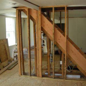

        1. dockelly | Jun 23, 2008 01:30am | #22
          did it exactly as you said, solid as can be. see pics.
