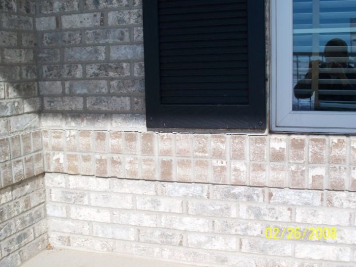

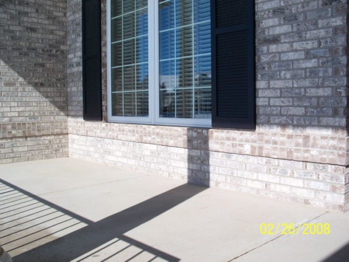

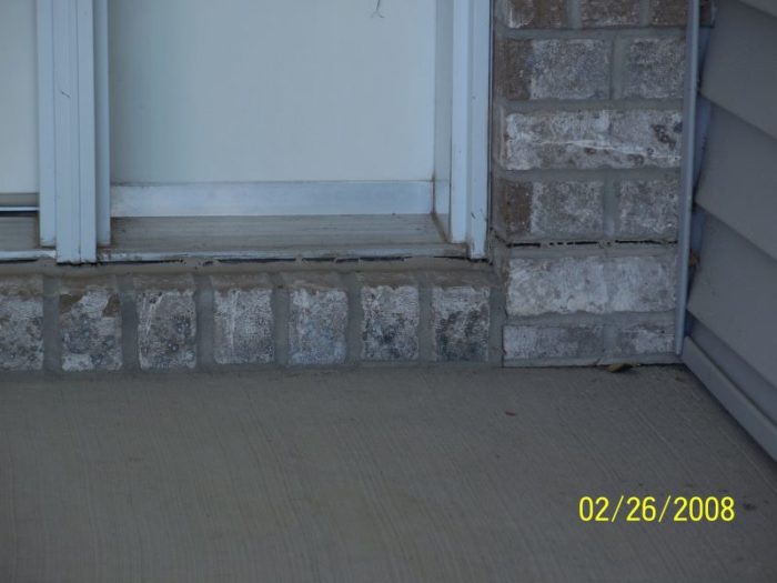

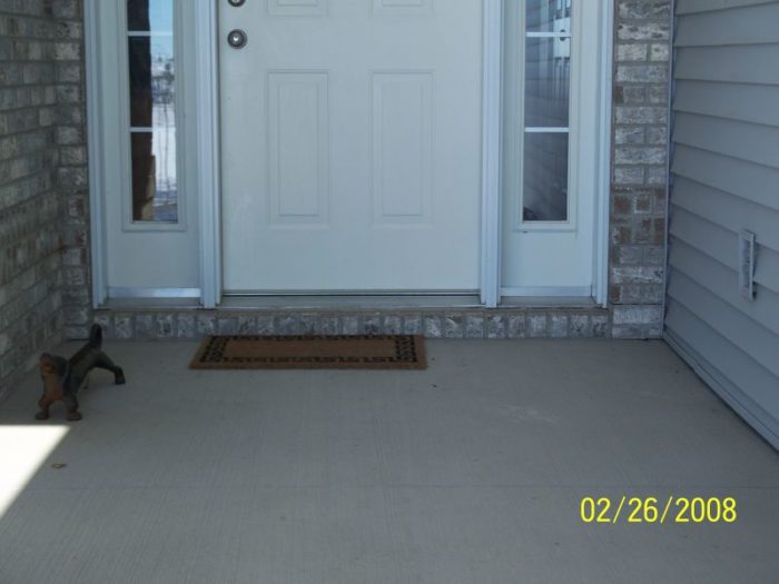

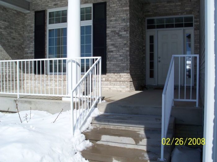

My 3 1/2 yr old house, in Iowa, has some settling of the front concrete porch. The porch is about 18′ Wide x 14′ Deep. It is settling where it meets the house. Under the front door threshold it has dropped about 1/2 inch. It’s also dropped between 1/8 and 1/2 inch pretty much the entire area where the porch meets the brick. Kind of hard to tell exactly with the caulk there, but it’s starting to pull away, again. It’s a little hard to see in pics since the caulk is concrete colored.
The builder came back a year and a half ago and recaulked. He said the porch couldn’t be settling because a footing was poured under the perimeter. Sure, a footing was poured under the railing area, but against the house(?)
One of my concerns is that it looks like the brick siding was set right on top of the concrete porch. Since the porch is settling the brick is too. There’s a pretty good crack to the left of the big window at sill height. The brick under the front door looks like it’s going down with the porch, too.
If the porch keeps settling, what’s holding the brick to the wall? Some brick ties?

Pictures are of the front door, lower right front door, left of the window, and the entire porch view.

Somebody framed the wall out all the way flush with the outside of the poured wall instead of leaving a ledge for the back of the porch pour.
Mason said it wasn't his problem............
The fix ? It is gonna run into money for sure. You need some concrete experts, one of em will be along shortly.

Check around for a good mason, most likely the slab will have to come out. There is something called mud jacking, although I'm not sure if it would work for this application. Holes get drilled in the slab and a mortar gets pumped into the holes to raise the slab. Trouble is it is likely to settle again.
If the slab is taken out, rebar can be epoxied into the foundation to support the new slab.

Tear it out and do it correctly.
