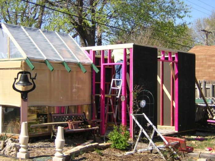

Consider what I did. My shed is 10' x 12'. I went to a bit more trouble than you might have to but I tamped gravel down 18-20" deep.
I set railroad ties over this gravel footer around the perimeter, spiking them together with 2' x 1/2" rebar and to the ground with 3' x 1/2" rebar. I then framed on top of the ties. I filled between the ties with 6" of gravel and that's all I have for a floor.

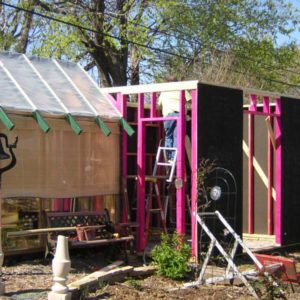

I had the ties and the gravel cost me about $40 delivered. The first frame shot shows a bit of the floor idea.
You could use 6" x 6" PT instead of ties.
If I had any studs the color of the studs in your photo, I would pay someone to burn 'em! :)

As to the color of the studs, etc -- I wuz wunderin whose took those old things from torn apart old picnic table I put out on teh street with the FREE sign <G>

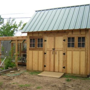

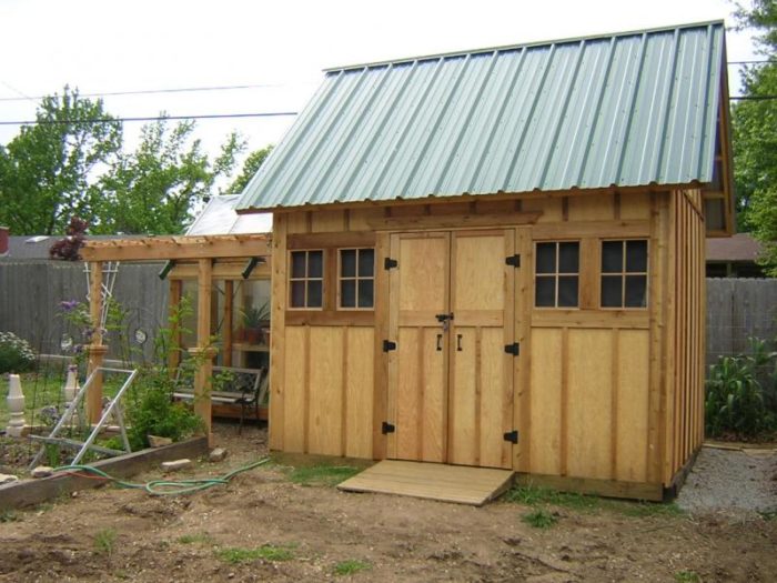

Hey, that's a great shed.
Tell me, what's the roof slope on the big shed, with the metal roof. Looks great, but I can't really tell the slope from the photo.
Thanks !
Greg
Pitch is 12/12 a nice 45. Made for a real easy roof to frame using only 4 rafters on the 12' run.
As to the pink studs they were straighter than you'd think for as cheap as they were..
That's a nice looking shed, but Dude, you got pink studs!
Like I said they may be pink studs but they're straight studs! ;)
Gaily colored straight studs, hmmm...
