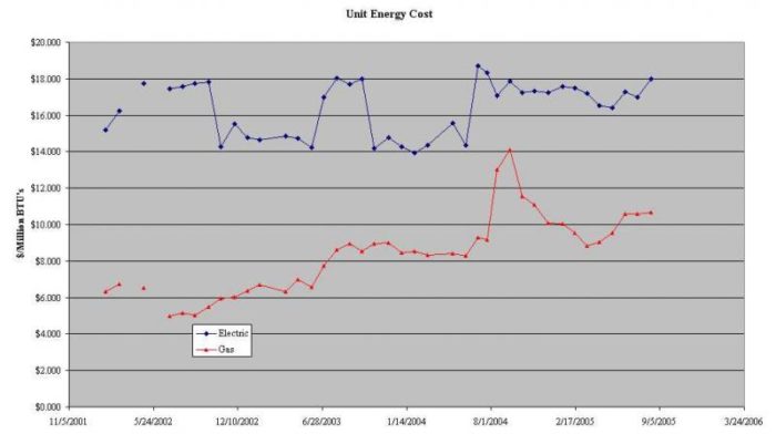

Our local gas & electric company (LG&E) has a current-price comparison (gas vs. electric) for water heaters, furnaces, etc.:
http://www.lgeenergy.com/rsc/lge/res_heating_costs.asp
Right now, in Kentucky, it costs about 30% more to run an electric heater. It also takes longer to heat up the makeup water.
However, there has been recent speculation that natural gas costs will triple vs last year. Electric prices (around here anyway) are not nearly as volatile as gas. I've been tracking energy costs for a few years. Gas is going up, electric stays about the same.
Note that this chart may not be 100% accurate. There are recurring monthly service charges that I tried to remove from the data, but I may not have been successful.
