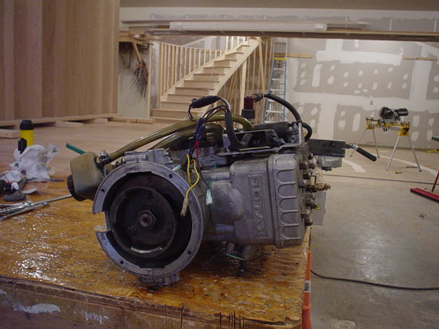

Boss: I would love flying down in that....I was having some ignition troubles tonight..it was backfiring..I was already doing emergency procedures and was coming down....then it lit up and I sputtered it back to the airport. Kind of scratching my head right now what it was.
So;;;till I get this figured out...I am not comfortable doing a long distance flight. I should have it figured out soon.
Do rotax engines have mags? I'm a big jet doctor. So unless it sucks burns and blows I'm guessing.If at first you don't succeed...try again! After that quit! No sense being a dam fool about it! W.C.Fields
jet: It has electronic ignition...no mags

So why the sputter? Water in the fuel? Fuel filter? after checking the plugs I would go to fuel starvation.If at first you don't succeed...try again! After that quit! No sense being a dam fool about it! W.C.Fields
jet: good question...I think it is one of my electronic "black" boxes. I checked my spark today...and there is none. I would rather have it completely quit..then I can trace it down easier.
To find intermitten problems here at work the spark farmers (avionics) use freezit. Cools down the electronic component to see if there is a loose connection. The cold causes the board connections to shrink so sometimes enough to cause the fault you are trying to find.
This may or maynot help.If at first you don't succeed...try again! After that quit! No sense being a dam fool about it! W.C.Fields
Jet: sounds like a good idea. I have absolutely no spark right now..so it has to be connection or the black box.
Good luck Stan.
Just remember the Hi tech Moto. Don't get mad get a bigger hammer!
The technical tap will do it everytime.
Hey I can't see it from 30,000 feet.If at first you don't succeed...try again! After that quit! No sense being a dam fool about it! W.C.Fields
I finally found my problem with the ignition. I tested my wiring harness coming out of the engine and found an open wire. I had to pull the motor,,then pull the flywheel. I found a wire that was rubbing the inside of the flywheel. It is all fixed now and I just installed the engine. I will be test flying it Monday.
Here is a picture of the chewed up wires on my ignition coils, and a picture of the engine in my shop....stairshop I should say.

Stan, that's a nice shop ya got there when you get all those pesky stairs out of the way.
Is that a single cylinder engine, or do I need to put my other glass eye in?
Joe H
Joe: Its a two cylindr Rotax...water cooled...64 horse. It is an amazing engine for its power to weight ratio. Perfect for flying machines. I had it up today and the ignition is perfect. It helps not having the coil wires rubbing the crankshaft. ha
