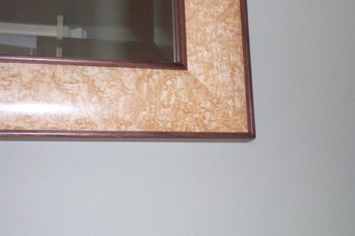

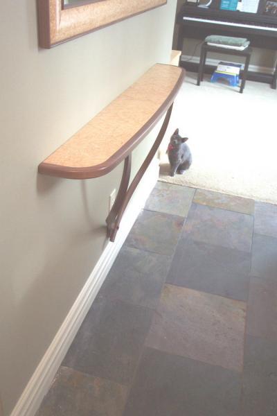

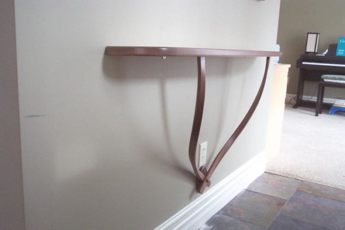

Photos of a recent project that’s a bit out of the norm for me as I usually don’t get a chance to build anything this small. Foyer hallway mirror and ledge. Birdseye veneer with walnut accents. Ledge supports cross over, twist 180 degrees and curve at the same time. It turned out to be one of these rare projects where the client said surprise me just build something unique. The frame & ledge is matching birdseye veneer. Ledge supports are laminated from 7 plies of walnut just a fuzz over 1/16 inch thick.

(I probably would have used something more elegant than the L brackets though most people would never see it.}Your right about the L-brackets lacking class however since I had a $700 budget for the entire project including a 500 mile round trip install I didn't think it was wise to spend a lot of time on something no one but the cat can see. The laminations consist of a stacked free form using spring clamps (see photos).The form is pretty basic. Full scale layout on 3/4 plywood. The vertical piece of plywood represents the ledge while the flat section represents the wall. The spacer in the middle suspends the laminates at the right height. The twist causes the curve to naturally flow out.Normally I would use a vacuum bag but I don't have one small enough. The stretch wrap holds the plies in line and for something like this the spring clamps exert plenty of pressure to produce an invisible joint.I have never tried the aluminum sheet you mentioned. What would be the advantage?

Are your bent lam's really holding that shelf up? or do you have some sort of torsion box going?
Hell, I dont mind the L brackets although I do notice the cat starring at them, maybe just trying to figure out how you made the curves!
Doug,The brackets support the weight nicely. I wanted to see what they might hold so I loaded a tad over 100 lbs of books on it still looked good so I assumed it might carry the cat as well.In retrospect I should have taken a photo of the supports before they were installed, they look like a big wishbone.
Wow- that's great. I was expecting a much more complicated jig for those supports. How did you figure the curve/twist to be what you wanted?

Thanks Zak,(How did you figure the curve/twist to be what you wanted?) Basically full scale layout, take a couple of thin strips of wood clamp them in place as see how it looks.(Haven't seen you around BT for a while, I was starting to wonder. . . ).In other words you were wondering if the mother ship beamed me up yet. Still here, bending nails and making sawdust.

That is awesome. So simple but so interesting.Is the slate on the floor installed with no grout joints?
