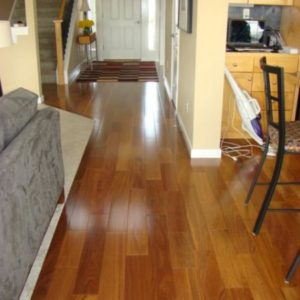

Hi every body, I installed a new brazilian teak hardwood floor (steel wood) and after of all I ended a little bit disappointed with some tools that I own, my dewalt 12 inch compound miter saw, it was just not strong for to cut this wood (new finish blade), my bosch table saw was just ok and I used a new blade (freud premier fusion 10″)but with this wood look like the nothing work well, Thanks God Im done !!! (the old floor was maple). any comments??? advises!!!

    Nice looking floor Paul.

  2. andybuildz | Mar 22, 2009 05:59pm | #2
    Looks great...I find that sometimes people use great blades on great machines but use the wrong amt of teeth for the machines. Some people think the more teeth the better and thats that...

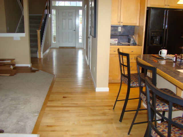

    The old floor looked good to me, and so does the new one. I am interested in why you laid the strips 90 degrees to the old floor. I presueme the old strips were laid perpendicular to the floor joists. What modifications did you do to lay the new strips, or did you lay the new floor over the old strip flooring?

      JDRHI | Mar 26, 2009 04:41pm | #25
      So long as the subfloor is adequate, it is not necessary to run flooring perpendicular to framing.

      i like the old floor better...
      1. wane | Mar 23, 2009 03:31pm | #11
        me too (I think) .. curious how much those wide boards will expand/contract, not wild about the bevel edges on the prefinished stuff, wish they'ld come in more than 2 or 3 lengthes.  However, the orig doesn't look good going perpendicular to the hall, don't like the washboard effect .. maybe tiled to the kitchen, or laid on 45º ..
        1. Pelipeth | Mar 23, 2009 11:09pm | #17
          Good point on the floor running perpendicular to the entrance. I too like the flooring to run in the direction to which I'm entering the room. That was an improvement.

      2. 123Paul | Mar 23, 2009 09:02pm | #14
        I liked the old floor too, but there were to much gaps, so any way...
    2. 123Paul | Mar 23, 2009 09:00pm | #13
      Well, the problem with the old floor was the gaps, a lot, and they don't wanted refinish the floor because is to mess, and yes this people have some money and they told me that they want to keep the economy running, so, good point do you think?

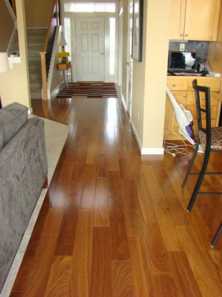

    Unlike the others, I prefer the wood and run of the new floor to the old. (Although I do not like the beveled edges of the prefinished flooring)
    One negative regarding installation I would raise, is that it appears from the picture, as though you ripped the boards at the transition between flooring and carpet.
    IMO, that should have been a full width board.

  10. Scott | Mar 26, 2009 07:57pm | #26
    Your floor follows the generally accepted design principle of laying the flooring parallel to the light. I think it looks great.
