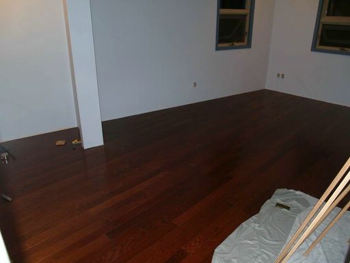

I finished installing hardwood floor in a bedroom last night. I’m about halfway done my 1800 sq ft install. It’s gone really well and I am very pleased how it is turning out.
The flooring is 3.25″ prefinished Bruce, stained cherry. Not the best quality but a good price and it looks nice once installed.
I’ve been laying down 15# felt atop the plywood subfloor, usually one 3 ft row of felt at a time, tacking it in place then laying the hardwood before laying the next row of felt out.

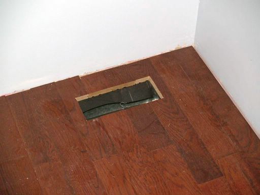

Once the floor was complete I realized that there should be one of these :
somewhere here : View Image

Tap on the area and try to find the hollow sound. It shouldn't be too hard. Once you find the area, you could you a flush trim router for at least most of it or all of it if you are able to get that close to the wall. If your using the wood covers then you need to be much more exact with you cuts.
Also, if you know where you joists are then you can narrow down the area. Look in the other rooms, everyone usually has a pattern with their work. Most will always keep the same spacing off the walls and two joists in from the walls, etc.

Like others said, most HVAC installers do follow a pattern, so I drilled a small hole in the floor where I thought it might be & turned on the furnace fan. I was pleasantly surprised to feel a little draft of air coming up that hole. A few cuts with circ. saw & the Fein and we were back in business.

Try cranking the furnace up high. Give it a minute or two to warm up. Drill a pilot hole through the centre of the warm spot. Finish it off with a jig saw.
