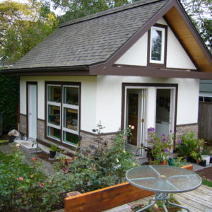

  5. semar | Oct 11, 2010 11:22pm | #8
    heating over garage
    I have nearly the identical situation. It is a "camping -out" room for the grandkids
    Make sure you have good floor/ceiling insulation (R20 min)
    I have an electric wall heater build into the wall on a thermostat. The unit has a build in fan which circulates the heat from the electric heating coils. The unit is 1500 W and produces plenty heat in short time. It is hardwired into the panel on a separate breaker
    1. semar | Oct 11, 2010 11:28pm | #9
      heating over garage
      another picture
