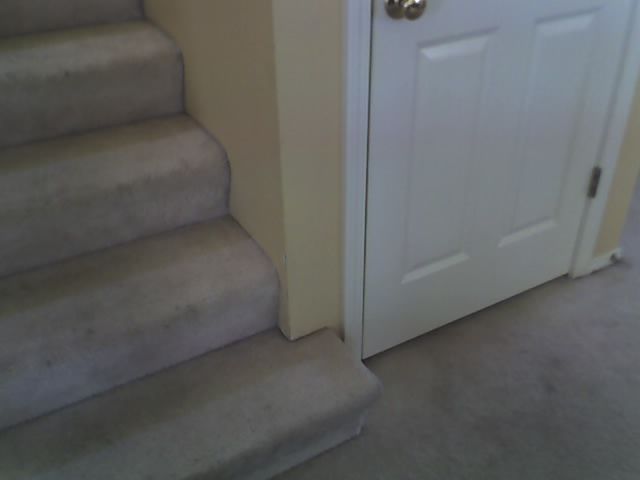

I don’t need exact how to , point me toward a book, Taunton resource, or something. I haven’t done stair skirtboards, and this stairway with it’s bottom and two turns has me puzzled. They are going to pull up the carpet, and I’m going to put the skirtboards, and then the flooring contractor will put in the new stairs (actually, manufactured laminated flooring 7/16″ thick) butted up to the skirtboards.
What has me a bit stumped is how to do the details at the landing and top. The skirtboards will probably a 1×8 or 1×10, and needs to meet up with the baseboard at the landing. Also that wrap around the wall at the inside of turn at the landing looks pretty knarley.
I know there is a “right” way to do it, and would like to get it right the first time.

That set of steps looks like an inexpensive track house finish package. The "baseboard" is actually casing...looks "tacky"! And the carpet probably covers the raw framing carriage.
If you add 7/16" of flooring to each tread, what will be the rise be at each step...it should be about 7" and consistent at all steps to within a 1/4".
For some reason the pictured steps look steeper than what is best considered at 7" rise/11" run! What is the actual rise/run, and is it consistent in the full run?
Like wise I see no handrail, which is a major safety consideration...even a requirement in areas where code is enforced.
Apron is usually installed beside the stringer as full width boards (un-notched) and the riser and tread boards are scribed to fit at each step, but for your descried application the skirt will be contoured to fit the existing. The gap at the tread can be covered by the added tread material, but how will you cover your sins at the riser.
How will you address the tread nosing if the flooring mfg. does not have such an item in inventory?

I like the paper pattern thread. I might just do that. And I like the idea of cutting the noses off too. I have no idea what the guy who's gonna put the engineered wood on the stairs is gonna do, my mission is just the skirtboards.
I like the idea of carrying the skirt board around the landing. Might do that.
You hit the nail on the head, this is small footprint tract townhomes.
Still wondering what I'm gonna do with the wall on the inside of the landing turn, though. Might just be a solid piece of wood 12" high. I can't leave the ends of the skirts just hanging out there on either side of the wall.

I'd wrap it with 1x to make it look like the bumped out base of a column. Use the skirt on the upper stair run to set your height and then keep the tops level as shown in the pics. Maybe the same motif can be done in the outside corners in regards to the column bases.
As for cutting the skirt, I'd see how difficult it would be to lift the existing treads off and then set the skirt board with no fancy/critical cuts to the walls then shorten/modify the treads to fit, any small errors will be covered by the flooring sub.

For what it's worth (I'm not a stair expert either): couldn't you just plumb cut the end of the skirt at the landing and let the "baseboard" molding butt up to it? (You could also add a plinth block there (removing a piece of the baseboard) or cut the top of the skirt horizontally so the upper corner isn't such a sharp point.) On that corner those little pieces of "baseboard" (molding) look bad--maybe just rectangular plinths there that the skirting meets? Or better, might be to trim that corner with vertical boards going all the way to the ceiling (the boards as wide as the treads are deep). Such boards would also protect that corner. Just some thoughts.

I think I'd probably omit the small baseboard, just carry the skirt, as baseboard, around to the next door casing or wherever the small base would not form a visual connection with the skirt-sized base, top and bottom.

After you get the carpet up, measure the riser height. Cut a section of plywood this wide and a little longer than a tread. Then tack your skirtboard up in position so that the edge of the board is resting on all of the steps. Place your little piece of plywood on the tread and mark the top. Then place a straightedge against each riser and make a line on the same side as the riser.

Finished job came out OK, I think. I had the skirts in first so the stair guys could butt up to them. That gave me 1/4" leeway on my cuts, which helped. Then I decided to keep the angles all the same, and use 5/4" stock corner pieces just proud of the skirts at the corners.
