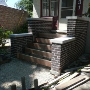

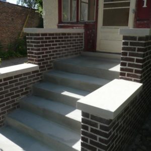

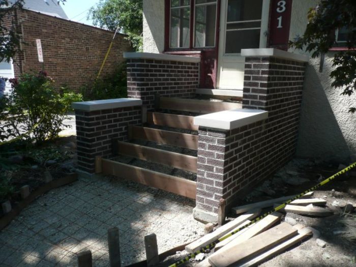

  I drew up some front steps for a bungalow to be poured between two brick parapet walls. The contractor seemed thorough and conscientious, and was a nice guy to boot. I wasn’t there for the pour, but it passed a pre-pour inspection, and from what I could tell, there was good rebar where it ought to be, and everything seemed to go smoothly. The steps were poured about July 10th, 2010 (see pictures). As of February 2011, the concrete was spalling all over- on the landing, every step, and the panels in front of the steps.
