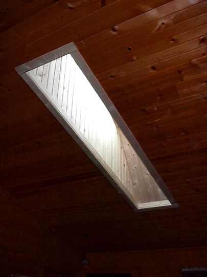

The skylite is in the roof. They loved the tube light I did for them yesterday, so the skylight was installed today...hose test tomorrow before we close in the chase.
Weaving the new shingles into the old roof was fun--a roofer I'm not.
Thank you all for the input, so far, so good.
Cheers.
Here is a pic of the skylite. The homeowners love it after all.
