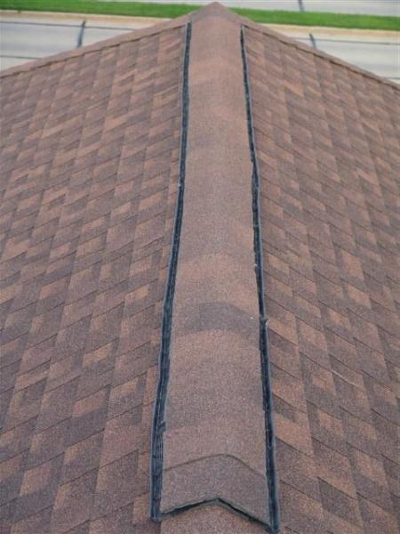

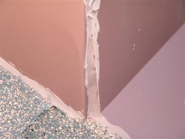

In the process of looking at their contract, I went up on their roof tonight and took the photos below. I would appreciate any comments you might have to offer. Is this job typical of a big box roof job? Typical of a roof job in general? I think that some of the flashing/weatherproofing details are lacking. The photos don’t show the dozen or so exposed nail heads scattered across the roof, nor do they show the un-reflashed fireplace chimney. (Contract stated “will reflash your chimney”. The furnace chimney was reflashed, as shown in the photos.

That's not the best job right there.
Technically, drip edge should go over the ice and water, but it's pretty common to put the ice and water over the drip edge.

I have seen that kind of workmanship all over the place nowadays. The roofer did not seem to know what step flashing and counter flashing is and certainly did not use it. Those kind of roofs are guaranteed leak. Was the roof inspected by a local building inspector? That would not have passed inspection where I used to live.
>>>>>>>>Existing clay tile roof was torn off and architectural shingles laid.
This is closing the gate after the cows are out, but more than likely, the only thing wrong with the tile roof was the flashings and the fasteners were worn out. The tile was probably still good. We've done jobs like this numerous times where we take off the tile, repair sheathing, install new underlayment, reflash, and re-install the tile, replacing what's broken.
Now, the guys that did this roof were average shinglers at best, but most of the issues are cosmetic. However, there is some tricky flashing on this roof and these guys don't have a clue. Get someone who knows how to reflash stucco and insist on using copper. There are some details that need to be soldered rather than caulked.

O.K. kind of a dumb question. Is that one of the big selling points behind copper flashing? That it can be soldered and therefore failsafe if done correctly? Verses caulk which will stop adhering or breakdown over time in certain conditions?

>>>>>>>>>>>>>Is that one of the big selling points behind copper flashing? That it can be soldered and therefore failsafe if done correctly? Verses caulk which will stop adhering or breakdown over time in certain conditions?Yup, plus it needs no maintenance like galvanized or terne which are the other two widely used flashing materials in these parts (both can be soldered - but will rust.)

Thanks. Now I know.

Grant was kind in his comments. This isa one of the gawdawfull worst flashing jobs I have ever seen. Ugly was visible from the street tho.
Why buy something that looks like that crap?

The contract writer has no idea of some roofing terms. There is no gutter on a rake. gutter hangs from the eaves. a gutter apron would pronbably be a skirt that goes over the gutter back and under the eave trim to keep water running the right way, downhill, withoiut diverting it behind the gutter.
The original tile roof had to have had metal valleys, but no sign they were replaced according to contract.

A chimney that smaall can live without a cricket if the flaashing isdone right, but they mention that it wsn,t done at all untill HD sent somebody baack out on it.Judging from the way that shingle immediately behind it rolls up, they probably jusst sshoved something in there with no proper prep like I&W.'Course, it don't leak when it ain't raining! LOL
