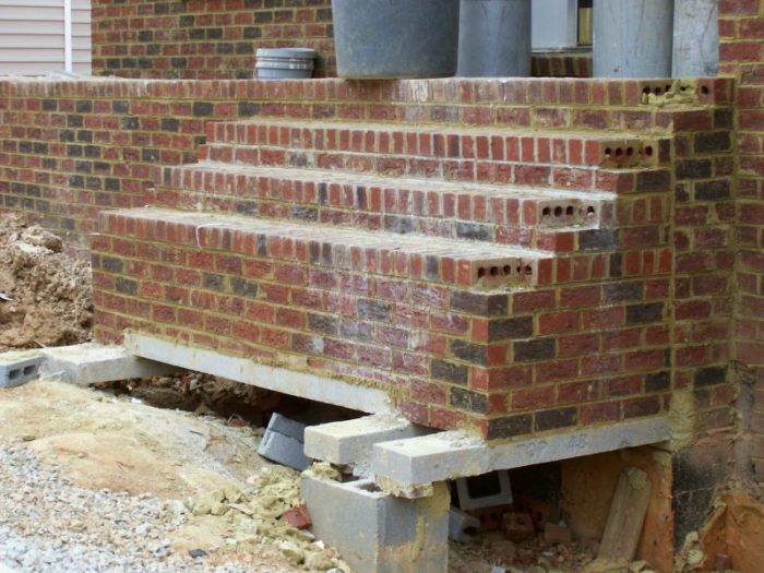

And this ...

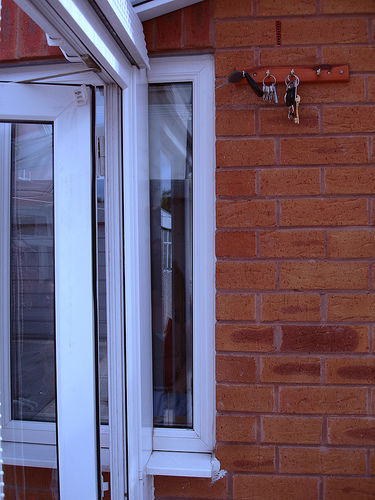

Found this on an English site. Posted by a guy (chap?) who is in customer service/warranty work for a conservatory company ... looks like sunrooms to me ... and he found this on a site visit. The installer, obviously not factory trained, installed the new conservatory wall across an existing window.
How do you suppose he's sealing the air leak between the wall that he butts up to the window? Maybe a big ole bead of silicone! That'd be my choice.
It may be the picture or the angle that the pic was taken from but the wall does not look plumb! But he did a nice job of notching out the trim for the wall to butt up to the brick, gotta give em credit for that!
Itlooks to me as if he did notch the sunroom side panel over the sill and over the lower sash.In thinking about the picture, it is weird, of course, but I'm not sure if (a) I'd even notice it and (b) whether it is "wrong"I'll note that there are few sun rooms in my area so I don't have the countless experiences with them to fine tune my "sun room construction detais sensor."
