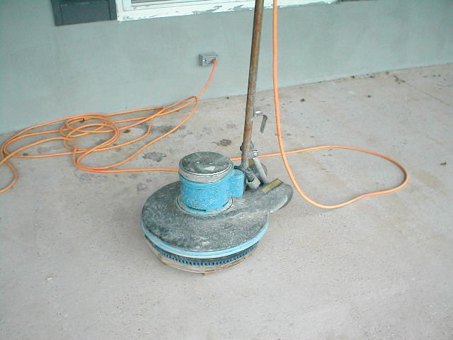

I had to smooth a rough concrete slab so I took a old floor buffer and fasten some house bricks to it, it works

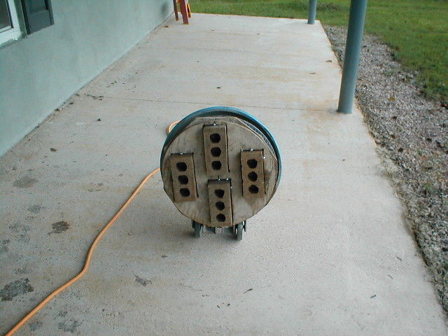

And did the bricks hold together or try to fling parts off?

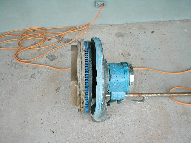

I gotta know -- how did you fasten the bricks and to what?

Looks cool. I'm also curious how you held the bricks on. Looks like a piece of 3/4" ply, and they're wedged in with screws?

No , its not balance too well, Its like the E ticket at disney land. Yes it will fling pieces of brick. Thank god it only 175 rpm and I got a pile of bricks. The bricks hold good with big sheet metal screws, I really have not solve that problem. And I bought the buffer at a yard sale for $50 to do my floors. The rental store for a concrete grinder was $75 a day.. If I switch from a red clay brick to a grey concrete brick it might work better.
No, its not really that loud about like a washing machine on a spin cycle
