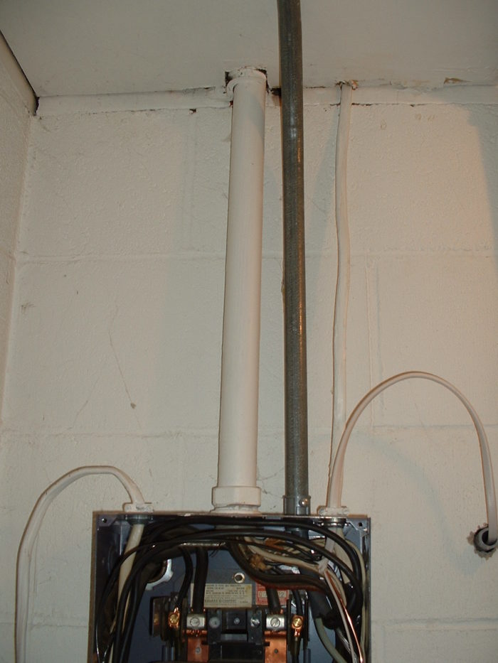

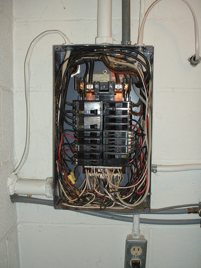

I think a few pictures are in order.
The second pic is of the rigid conduit going up into the ceiling. that is where my wires go. Chances are that the conduit ends in the ceiling so i could get the wires out of the conduit.
The third pic shows a lot of wires exiting the panel through a secong rigid conduit on the left. Many of these are cloth wroapped.

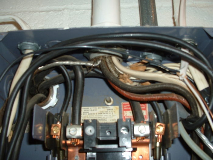

The fourth pic shows the red and balck cloth wrapped wires exiting up into the conduit. These are the two I would like to get out of the panel and the conduit.

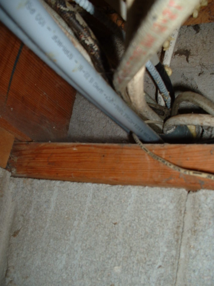

The fifth pic is in the crawlspace to the left of the panel where the wires dump into the crawlspace.
They just used the conduits to get the wires into the walls or crawlspace. Maybe they thought they would frame and drywall that wall eventually.
Be aware that some wiring of intermediate age has a cloth covering over plastic/rubber insulation. If the cloth has been stripped away it may look like regular plastic-insulated wire.
Thanks! I'll check some out.
Thanks! I'll check some out. It might be. The house was built in the late fifties or early sixties.
Also be aware - that [most] cloth covered wire had rubber insulation which affected the copper wire; the copper wire was thus tinned to a silver color which can mistaken for aluminum wiring (for example, by a then inexperienced home inspector (I "hear"))
Thanks! I've work with cloth
Thanks! I've work with cloth wrapped wire in old homes. I think I remember there being a layer of plastic or rubber that disintagrated when I touched it. more like old dried up rubber.
