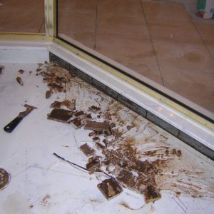

Client with an upscale 10 yr old house asks me to remove the carpet in the master bath and replace it with ceramic tile.  Due to hubby’s resistance to change, it has to be done the week they are out of town so he won’t have to use the other bathroom for 2-3 days.  Oh, and while you’re there, can you re-caulk the shower?

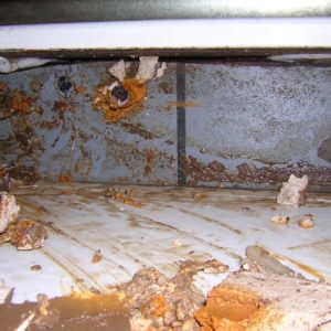

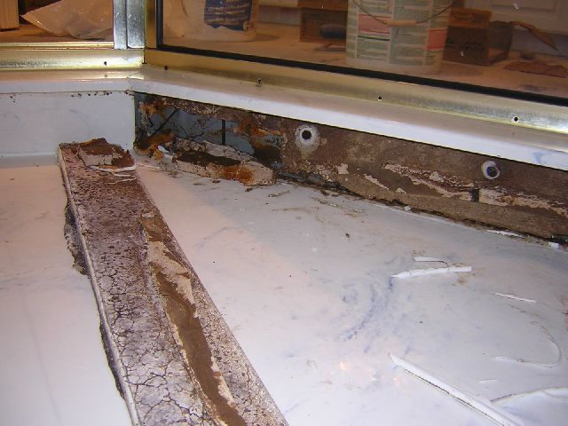

The large walk-in shower is made of a cultured marble (I love that oxymoron) base with same wall panels.  So I start peeling off the old silicone caulk, and it comes off pretty easy.  And the back side in kinda black and nasty, a little slimy in places.  Then I find that one of the acrylic side pieces between the base and the window sill is loose (ok, so it’s not a window sill…but it’s what is under the large glass panel…so what is it called?)  Pull it off and find a nasty glob of rotted moldy sheetrock.  See the attached pics.
Looks like the installer decided he needed to shim the trim piece out a little farther from the framing, so he inserted a piece of sheetrock.  Looking closely, I can see that they used a good rubber liner and turned it up the wall, but it didn’t get turned over the top of the framing…so that means it’s not going to stay in place…no problem, they ran sheetrock screws through the liner about 1-1/2 to 2 inches abouve the base.  And they used more screws to secure the sheetrock scraps in place.  Of course now all that’s left are the heads, and a sliver of body.
As I’m peeling off the old silicone, water starts leakiong out into the shower.  And after all the crud is cleaned up, I can see water sloshing between the membrane and the underside of the acrylic base….so that means that the weep holes in the drain are plugged.
Oh, and it stinks.  The smell is just wonderful.  Now, are there any questions as to why you should use Durock or Hardie in wet areas?

      The right way would be to take the whole thing apart and rebuild it.  Since the entire enclosure is acrylic panels, with a little bit of luck and careful prying it could all be reused.

        Cut a piece of denshield, coat the cut with caulk, glue it in with caulk, get paid and get the heck out of there before you catch some disease or something.
        No matter what you do, other than a complete rebuild, it is not the right thing, and it is not going to last. NO GUILT!! Patch it up and run.

        Same way I'd fix a leak in a concrete basement wall--fill the void with Polyplug (hydraulic very quick-set cement mix; http://www.bomix.ca); trowel it flat (real fast), add some thinset with a 'flashing' of Kerdi membrane stuck in it and stick the panel back in place. Caulk.
        Open up the drain; clean the weeps or drill new ones with a short bit in a cable wand on a Dremel.
